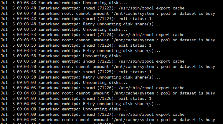

After following spaceinvader1's latest guide of upgrading your cache drive to zfs I can't reboot my server. It just hangs trying to unmount drives. Trying to destroy a dataset on that pool states that it is busy so I believe that is the issue also affecting unmounting and reboot. What can I do?

I was trying to take my array offline this morning, and was met with the same issue.
I ended up doing sudo shutdown -r now via command which seemed to kick the server, albeit uncleanly.
I'm going to move the system share off of cache to see if that resolves my issue.
Moving the system folder off of the zfs dataset seems to have resolved my issue. I'm going to guess it's because of the always in-use syslog files. That's pure speculation though, if anyone has more information.
Thanks!
Do you mean from the syslog server? Docker logs should shutdown when the service is stopped.
yes
Yeah, I had the syslog server on historically for troubleshooting. I've turned it off and will move /system/ back to cache and report back if I have any other issues with the locking of zfs datasets.

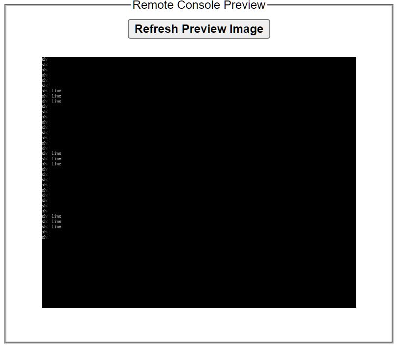

using shutdown in the cli hung just the same and I had to cold reset. Looking at the remote console before I power cycled looked like this (if it helps):
also after reboot I still can't destroy that dataset, pool is busy
