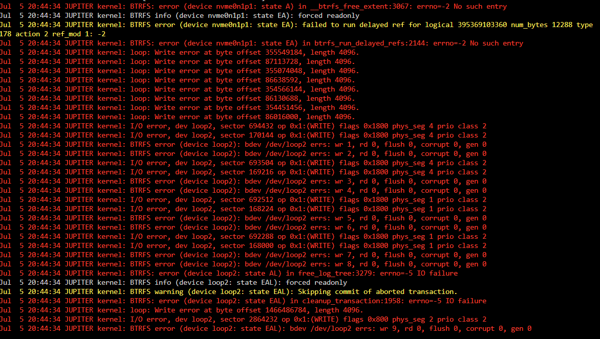

Over the the past couple days I discovered an issue which prevented my cache drive pool (2x 1TB nvme ssd's) from working - it was on a read-only state. After rebooting it said there was no file system found. I was able to remedy this and get it going by performing this command:
btrfs rescue zero-log /dev/nvme1n1p1
After performing this command and rebooting, it works for maybe 10min and goes back in to a faulty state. I then removed the drive nvme1n1 thinking it was faulty - ran the rescue command above, rebooted and all was well - albeit I only have 1 cache drive in my raid1 pool so I wanted to replace it with a new drive.
I inserted a brand new Samsung 980 PRO in to that slot, booted up, added the Samsung drive to the cache pool, and now I'm back to having a faulty cache pool again.
So... I guess the drive was never bad? But I'm not sure what is the issue here. I've attached diagnostic logs as well to the post.
Appreciate any help and input!
Thanks
jupiter-diagnostics-20230705-2052.zip
