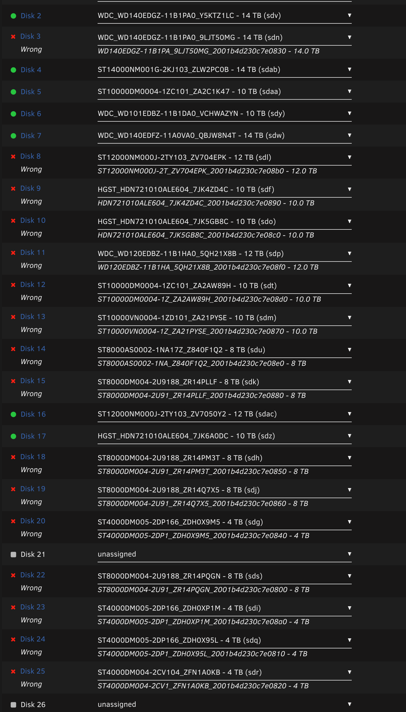

July 10, 20233 yr I just had my 16 port HBA die, fortunately I have two HBA's on hand that can handle 8 drives each, however to use them I have to pull my P2000 which I have been using for Plex transcoding. How do I change the parameters of the Plex docker to utilize the iGPU in my 11th gen Intel CPU, if the Plex docker won't even start after I pull the P2000 and start the server? My bigger problem is that unRAID now things many of the disks are in the wrong slots. I think if I do a new config and reassign them as they are now and were prior to this issue, the array should start and I should be ok? Thoughts? Edited July 10, 20233 yr by ashman70
July 10, 20233 yr Community Expert 4 hours ago, ashman70 said: My bigger problem is that unRAID now things many of the disks are in the wrong slots. If it's an LSI it might need a firmware update, but yes you can also do a new config.
July 10, 20233 yr Author Thanks I got it sorted out, but now I have one drive in pre fail state and one drive showing unallocated sectors. I'm crossing my fingers the parity check completes without errors as I only have one parity drive.
