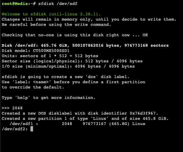

July 11, 20233 yr Community Expert type sfdisk /dev/sdf then type 2048 and hit return post a screenshot after doing that

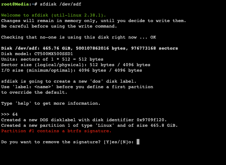

July 12, 20233 yr Community Expert Hit CTRL +C to abort and retry but now with 64 instead of 2048 and post new screenshot.

July 12, 20233 yr Community Expert 22 hours ago, JorgeB said: type sfdisk /dev/sdf then type 64 and hit return post a screenshot after doing that

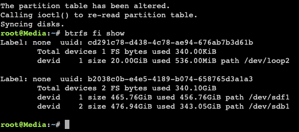

July 12, 20233 yr Community Expert Type N + return to keep the btrfs signature, then type write and hit return Now do the same for the other device type sfdisk /dev/sdb then type 64 and hit return Assuming it also finds a btrfs signature type N + return to keep the btrfs signature, then type write and hit return Then post the output of: btrfs fi show
