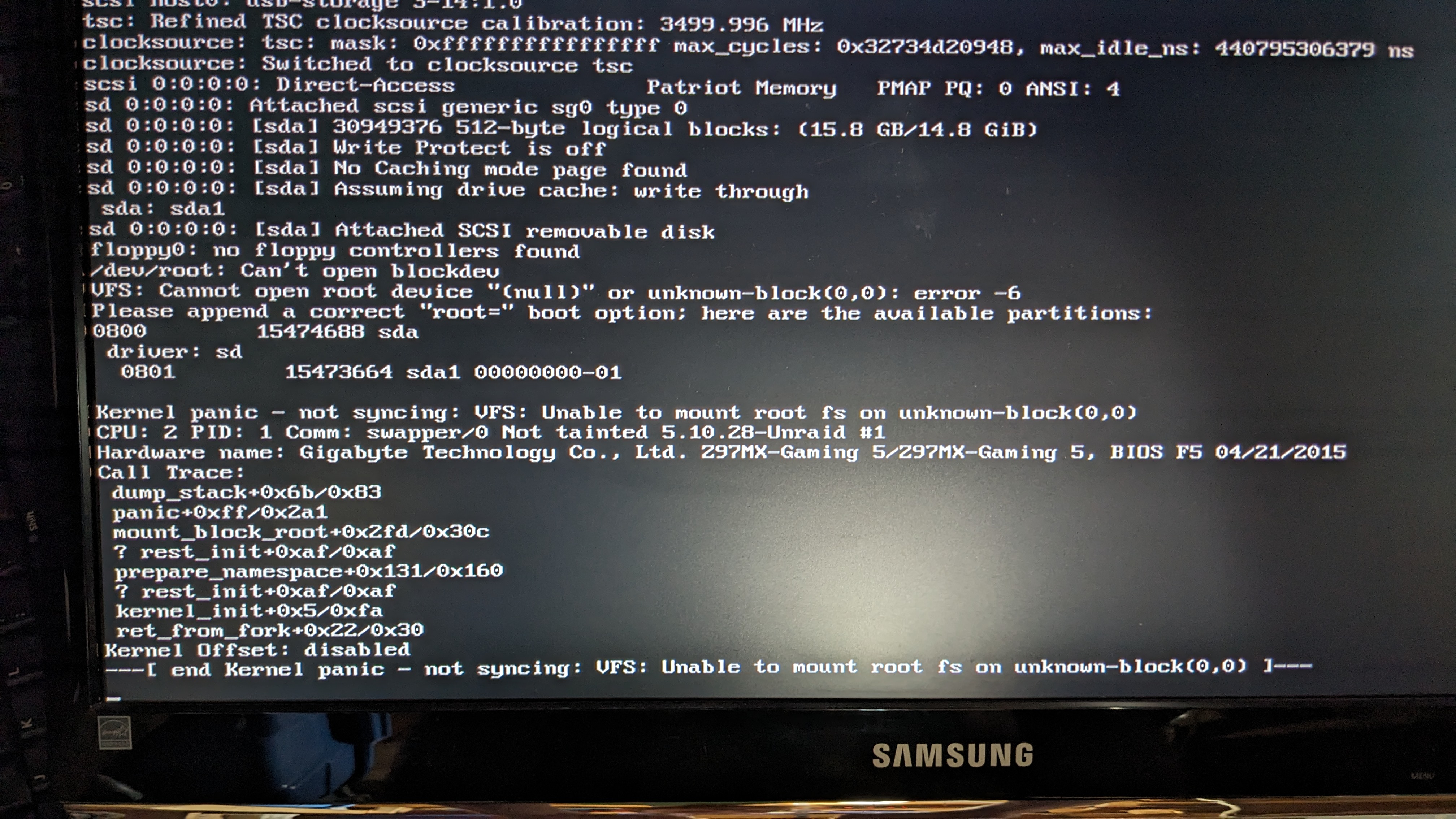

And that's where I am now. Kernel panic with the bare essentials: CPU, mobo, RAM, bootable USB, USB keyboard, monitor. Panic with fresh unRAID install or copied-over old unRAID config.
I've attached the last diagnostic I ran as well as a picture of the kernel panic error on screen.

10 hours ago, CasanovaFly said:
New USB that's confirmed working as a boot device. No dice.
If this was a new flash drive with a stock Unraid install and it still didn't boot, and before it did, it suggests a hardware problem.
Occam's Razor. After a night's sleep, seemed to be the most likely.
Went back to old hardware that was working before the issue and same thing, same panic.
Started trying to great different images/boot versions of unRAID on different flashes, got nowhere.
Until I noticed that a fresh overwrite install by the unRAID USB Creator didn't actually overwrite anything. All the same (likely corrupted) files were still there. So I deleted everything, downloaded a .zip of the latest unRAID, copied over to original USB... boots!
Copied over my config folder... boots!
So I seem to have solved this. Seems like some files on the USB got corrupted along the way.
