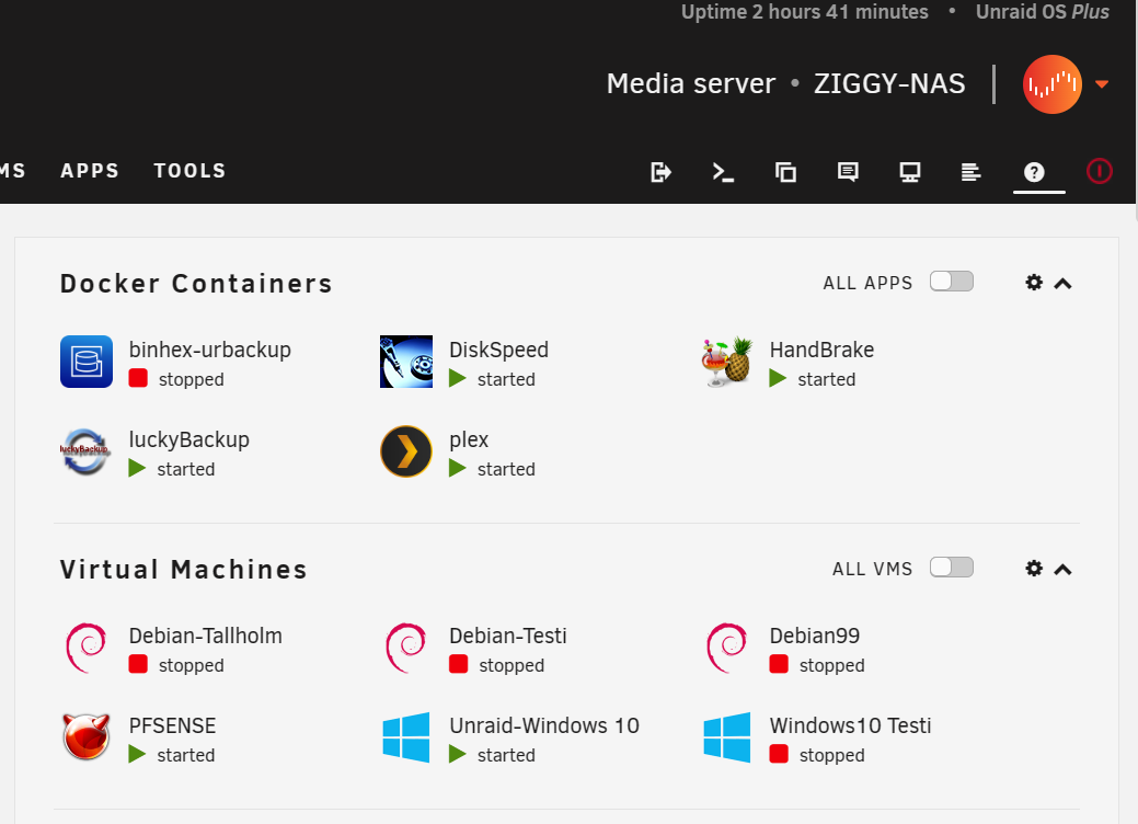

Jorge, you are awesome, thank you!! I'm up and running again.
Two of the Debian VM's don't work, but atleast one of thme should just be a matter of fixing grub.
