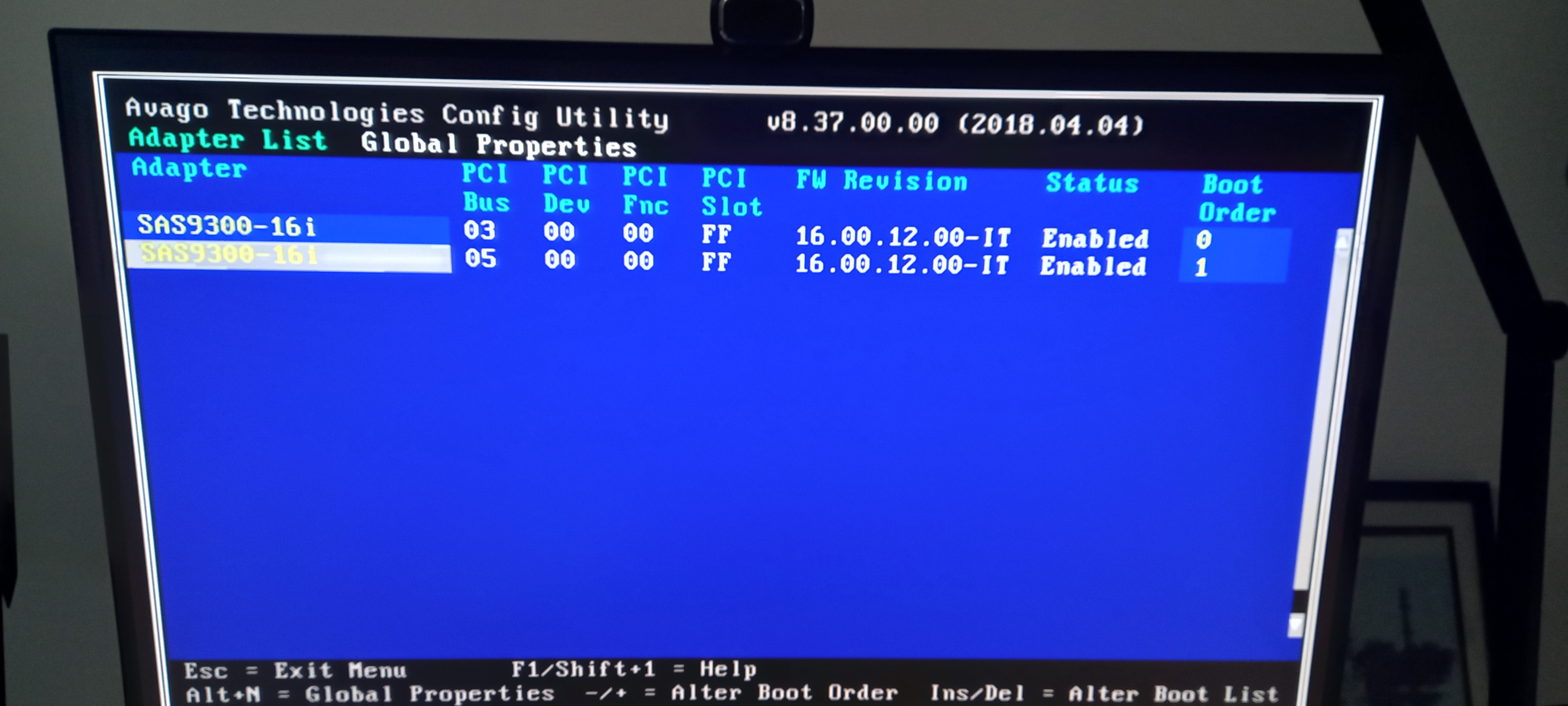

Bought a 9300-16i on ebay and used SAS3FLASH to change the firmware to a newer version. See image. Both controllers are on version 16 (previously it was 8.X.X.X), but I still can't detect any drives via the card.
Is there a newer firmware version I need to use, or do I need to change some settings in Unraid?

I've attached all cables to the HBA and connected one drive to each port. Seems like it's only detecting 2, so perhaps one of the controllers isn't working. I'll swap out some more HDDs to see if it's an error with drives or cables are bad.
