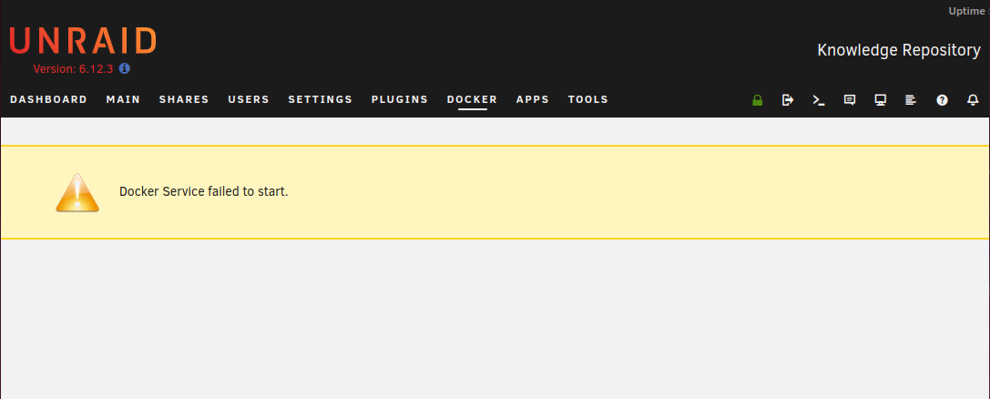

July 18, 20233 yr Hello, My docker service is not starting and is not returning much when it fails. It tries to start, acts like it's going to start, but then stops without much in the error messages. Looks like it may be an issue with `iptables -t nat` based on the logs I could find but I am unsure how to overcome this. Server is a Dell R510 with 2*X5670 CPU, 128G RAM, and a DAS. It is not overclocked. Not much is publicly accessible. I am running UnRaid 6.12.3. The problem started when I upgraded to 6.12.2 from 6.11.5. On the previous version the docker service ran many containers but fails to start through the upgrades. Symptoms: 1) On the Docker web GUI tab the message "Docker Service failed to start." is displayed in a yellow box without further errors. 2) Syslog says: Quote Jul 17 16:57:51 Asgard kernel: BTRFS info (device loop2): enabling ssd optimizations Jul 17 16:57:51 Asgard root: Resize device id 1 (/dev/loop2) from 25.00GiB to max Jul 17 16:57:51 Asgard emhttpd: shcmd (175): /etc/rc.d/rc.docker start Jul 17 16:57:51 Asgard root: starting dockerd ... Jul 17 16:57:51 Asgard avahi-daemon[7186]: Server startup complete. Host name is Asgard.local. Local service cookie is 113882372. Jul 17 16:57:52 Asgard avahi-daemon[7186]: Service "Asgard" (/services/ssh.service) successfully established. Jul 17 16:57:52 Asgard avahi-daemon[7186]: Service "Asgard" (/services/smb.service) successfully established. Jul 17 16:57:52 Asgard avahi-daemon[7186]: Service "Asgard" (/services/sftp-ssh.service) successfully established. Jul 17 16:58:24 Asgard emhttpd: shcmd (178): umount /var/lib/docker 3) Attempting a CLI start returns Quote :~# /etc/rc.d/rc.docker start no image mounted at /var/lib/docker 4) /var/log/docker.log shows several identical messages Quote :~# cat /var/log/docker.log time="2023-07-17T16:57:54-07:00" level=warning msg="containerd config version `1` has been deprecated and will be removed in containerd v2.0, please switch to version `2`, see https://github.com/containerd/containerd/blob/main/docs/PLUGINS.md#version-header" failed to start daemon: Error initializing network controller: error obtaining controller instance: failed to create NAT chain DOCKER: iptables failed: iptables --wait -t nat -N DOCKER: iptables v1.8.9 (legacy): can't initialize iptables table `nat': Table does not exist (do you need to insmod?) Perhaps iptables or your kernel needs to be upgraded. (exit status 3) 5) Running `iptables --wait -t nat -N DOCKER` does indeed fail with the error message above Quote iptables v1.8.9 (legacy): can't initialize iptables table `nat': Table does not exist (do you need to insmod?) Perhaps iptables or your kernel needs to be upgraded. Attempted fixes: 1) Removed docker.img and let the system recreate it. 2) Tried several GUI docker setting options like macvlan and ipvlan, not preserving user defined networks, a larger vdisk size, btrfs vs directory, and a 5 minutes timeout just so it may get over a hang. 3) Cleaned out my go file of things not needed due to various upgrades and plugins. 4) Rebooted. 5) Installed the newer update and rebooted. 6) Manually ran: `iptables --wait -N DOCKER` and attempted to start the docker service with cli /etc/rc.d/rc.docker start However no matter what I attempt I am unable to make a difference in the symptom. Please advise, asgard-diagnostics-20230717-1444.zip Edited July 20, 20233 yr by cYnIx

July 18, 20233 yr Community Expert Problem appear network related: failed to start daemon: Error initializing network controller: error obtaining controller instance: failed to create NAT chain Don't remember seeing this particular error before, but try resetting network settings to default, and delete any custom docker networks.
