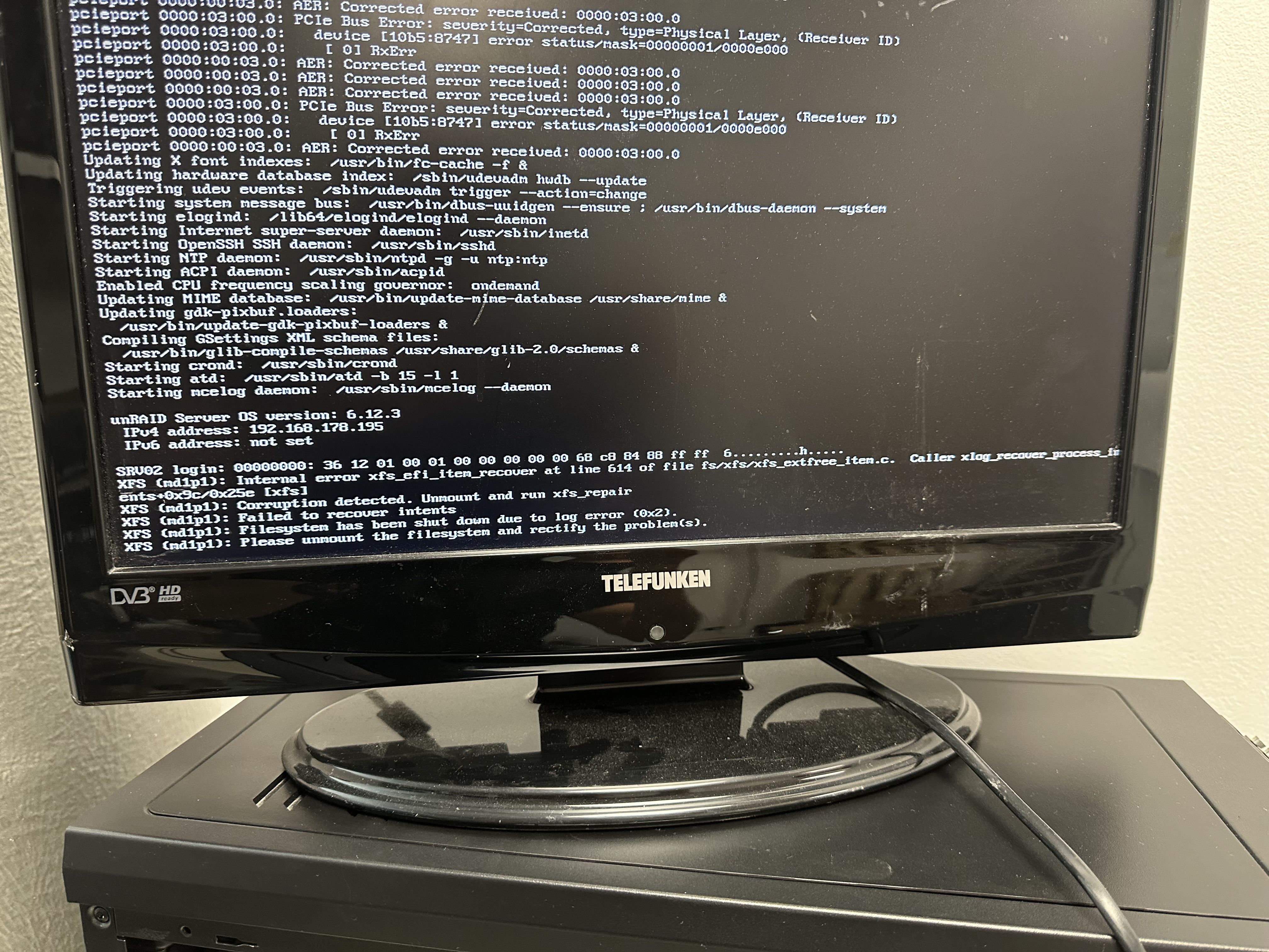

Do you think it’s related to the NVMe drive? I also read here that the issue may be caused by a bad sata cable.
Here I post the error of corrupt drive that I see after boot
I solved the spam issue by adding pcie_aspm=off
but I still have an unmountable disk

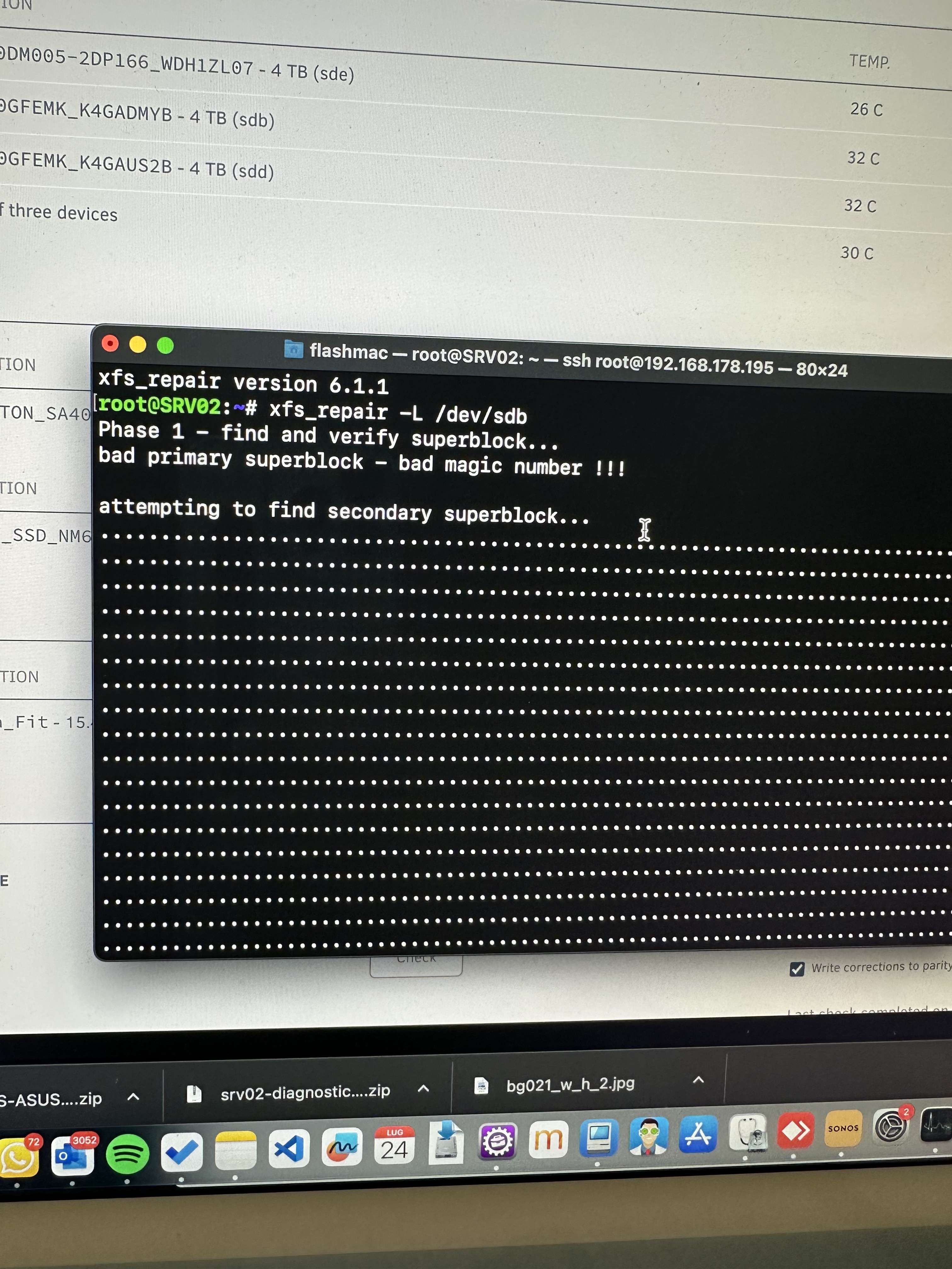

The command you used is wrong as you always need to include the partition number.  Ideally you should run the repair from the GUI as then the correct device id will be used.

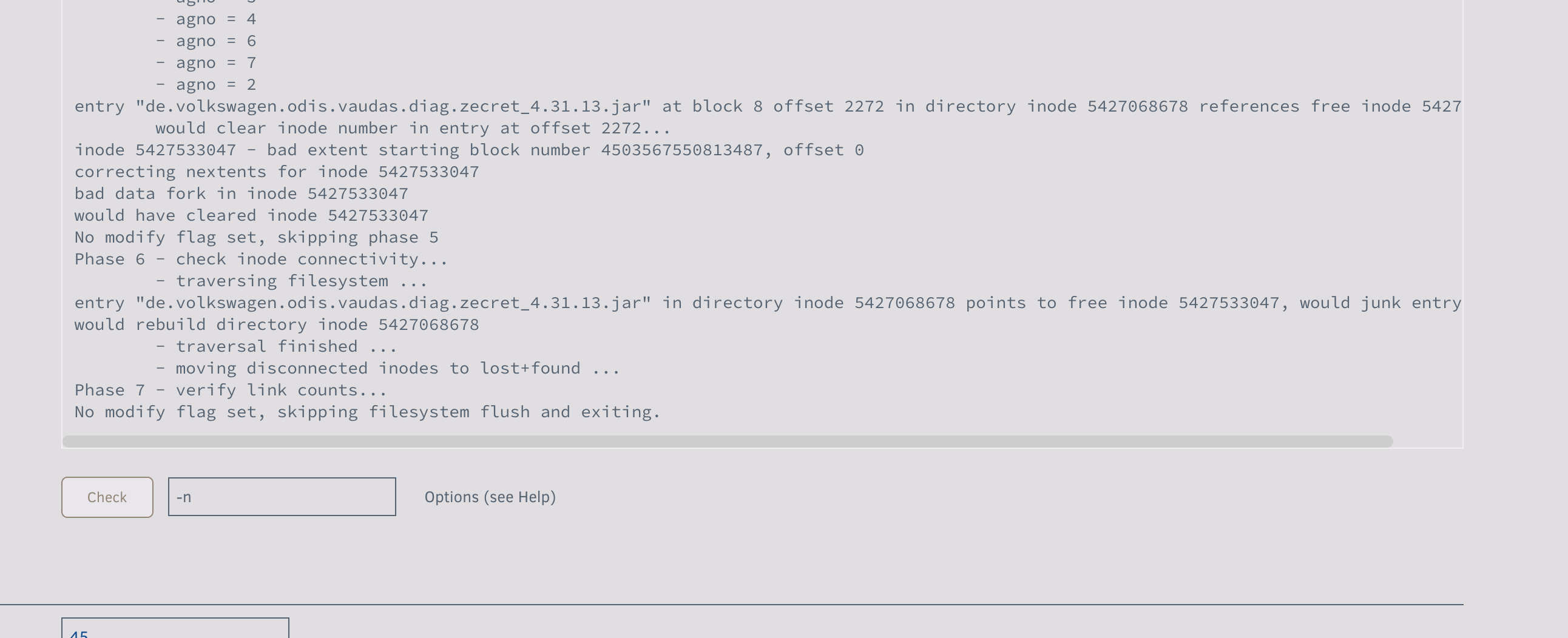

Ok, tried that
here's the log but the drive is still unmountable
1554299310_Screenshot2023-07-24alle18_17_15.thumb.png.dc3959aa06cd4e3ad366dcea5debf168.png
You ran with -n set which does a read-only check.   If you want any fix to be made then you need to remove the -n, and if it asks for -L then add that.   After that the repair should be done and the disk then mountable.
