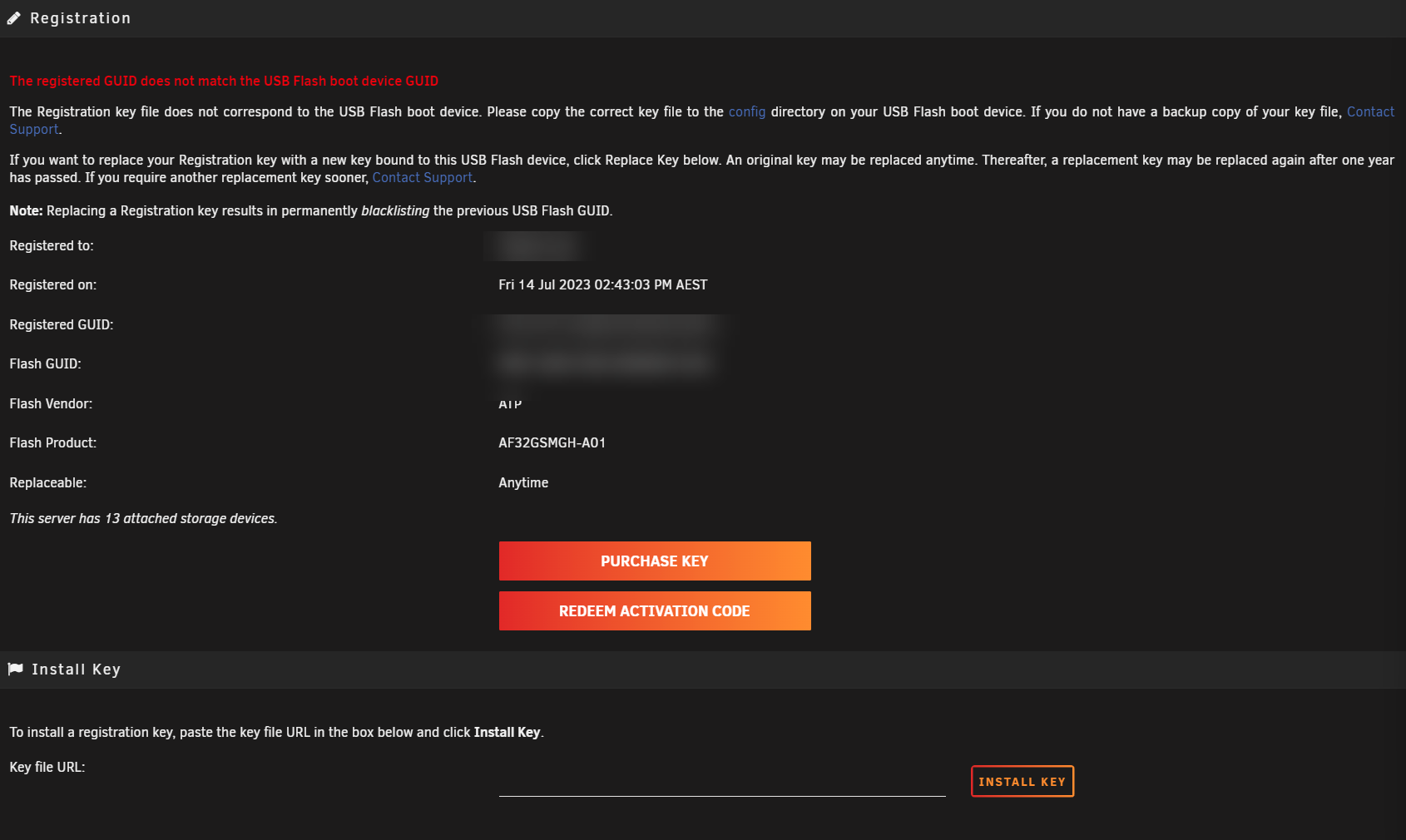

I just installed a new DOM-based USB key for my server, following all of the instructions located at https://docs.unraid.net/unraid-os/manual/changing-the-flash-device.
There is NO "Replace USB key" option, and it appears this is because I upgraded my license on the 14th of July.  I have had this USB key for over four years.  This is ridiculous, why is a license upgrade classed as a "key replacement"?

That screenshot shows "Replaceable: Anytime" so it doesn't appear to be a too soon issue.

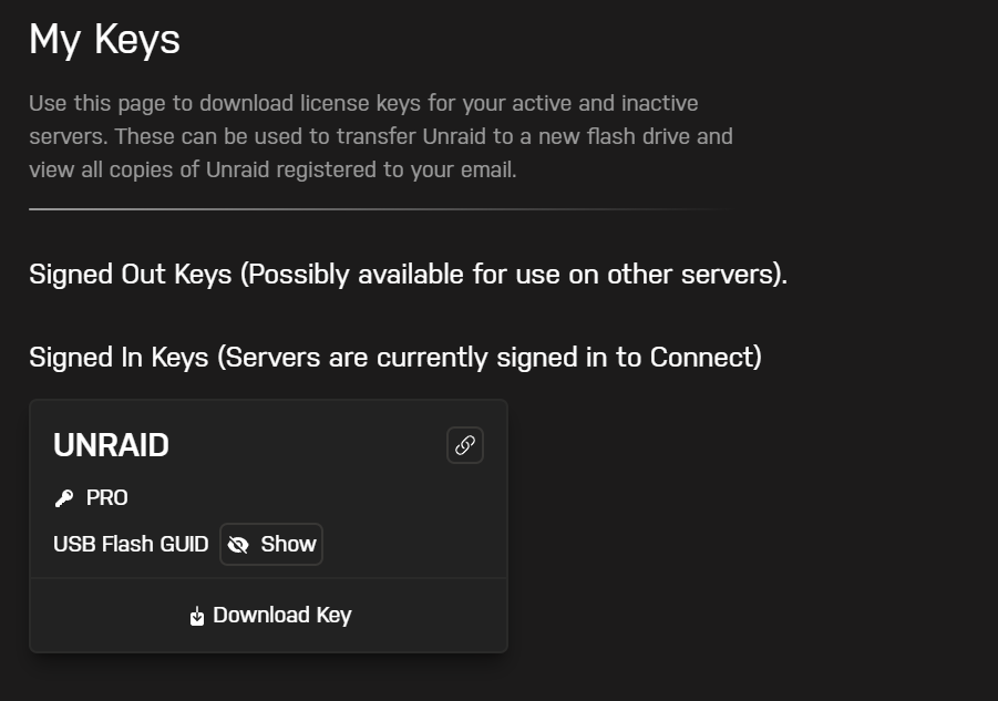

I have access to all that, and it looks like the image below.  Unfortunately there appears to be no documentation on "Signing Out" a key and what that all means.
It drives me up the freaking wall when I find this lack of documentation update.  Documentation must never be delayed and must be part of the release process!  It keeps a high workload on the tech support folks when there's just no need if the damned documentation would be updated.
