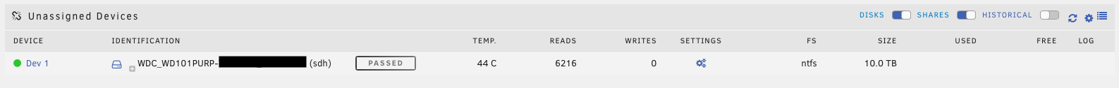

I have the Unassigned Devices plugin installed, and I have the entire 10TB drive set to Passthrough within the device settings (see screenshot below).

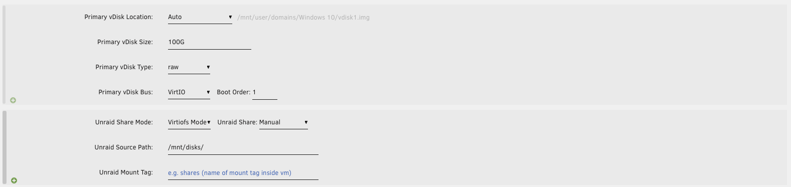

I'd like to ensure the boot drive uses the Unraid cache drive SSD, but I want to have the WD drive as another drive available within the OS for the purposes of writing all Blue Iris recordings to. How do I achieve this within the VM configuration page?
266536607_Screenshot2023-07-28at1_21_46PM.thumb.png.4009563463517fefdd6798c53cb256c5.png
 I've seen some posts within this forum and the subreddit suggestion adding an additional vDisk location, setting to manual, and then specifying the disk by ID, but I'm not confident I'm doing this correctly.

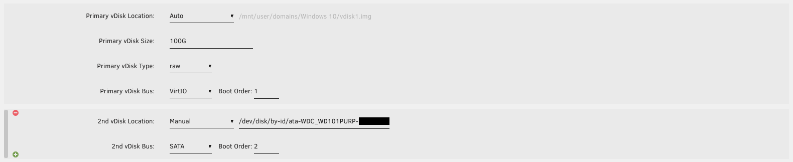

You can look up your exact device-id using the unraid terminal. Just execute `cd /dev/disk/by-id` command at root
And then `dir` to get a listing of all the drives available to you
Make sure to use the first listing of your device. The one without the part whatever at the end.
...then "set vDisk Location" to manual and the location as /dev/disk/by-id/<your disk>
1433498269_Screenshot2023-07-28at1_28_15PM.thumb.png.d3249769e7beb171eed2a55641114cb5.png
Could someone confirm that I'm doing this correctly, or let me know if there's anything I need to configure or consider before proceeding?
