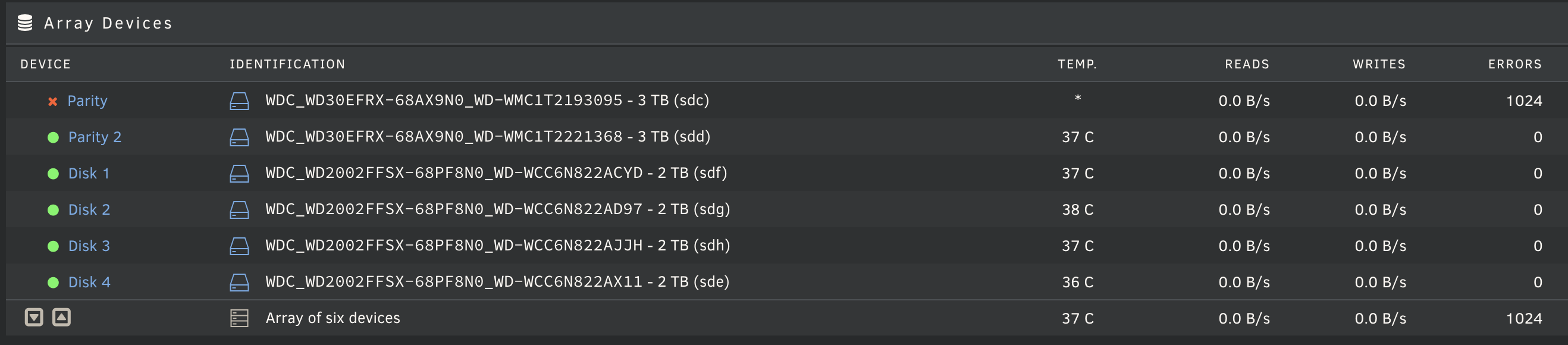

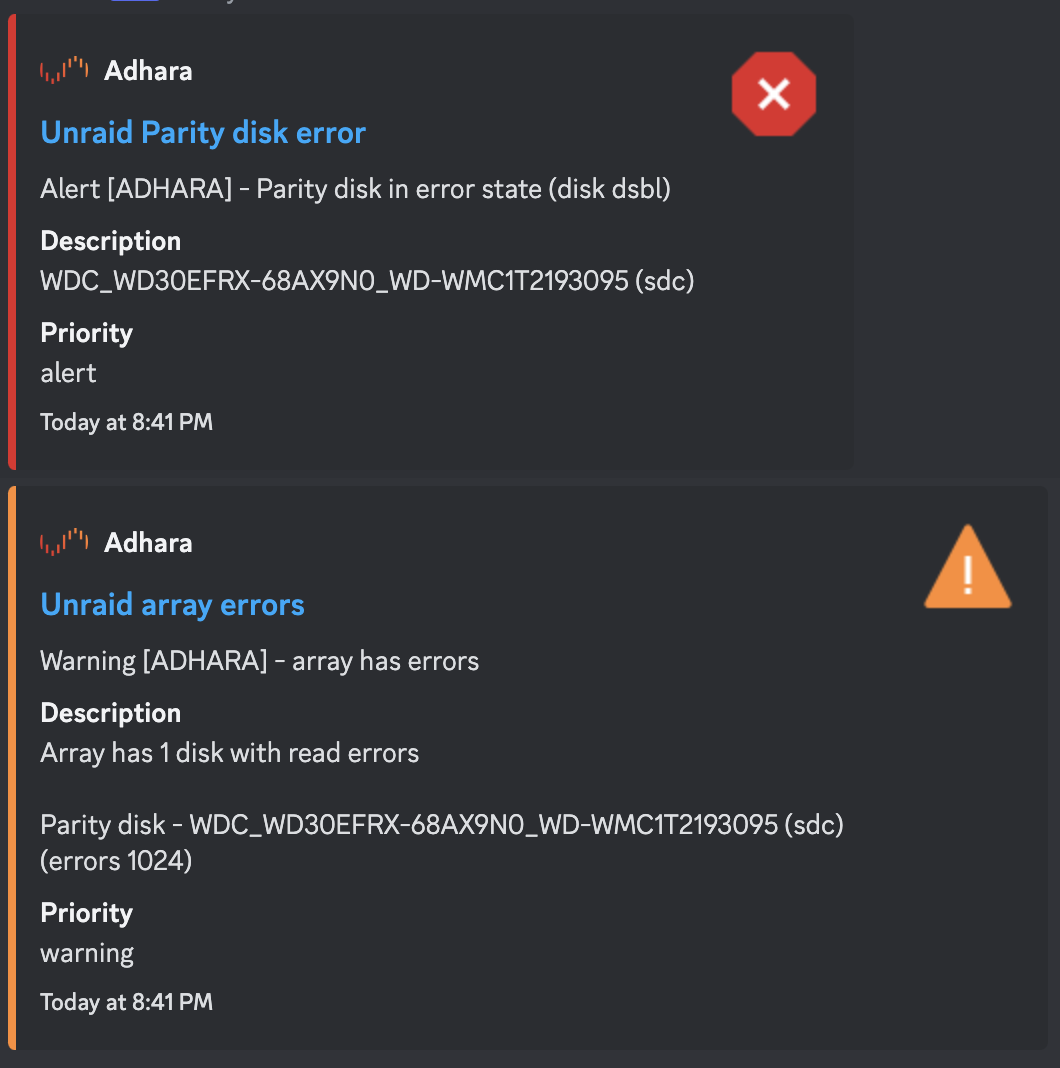

This last step never succeeded, I did it 3 times and I get the same error all the time where it says "Parity disk in error state (disk dsbl)" and shows 1024 errors.
Am I doing that wrong or is my disk faulty?

But I do think the disk is faulty cause I swapped it with the one that has no issues (swapped physical place, sata and power cable) and it's failing again while the other is syncing without issues.
To be 100% sure I would need to test with another drive to see if my setup can handle 6 spinning drives at once but I don't have any left so I'll just end up using a single parity drive.
To be noted that these drives are 10 years old and have been used 24/7 in my previous NAS, it's not impossible this drive is actually faulty
