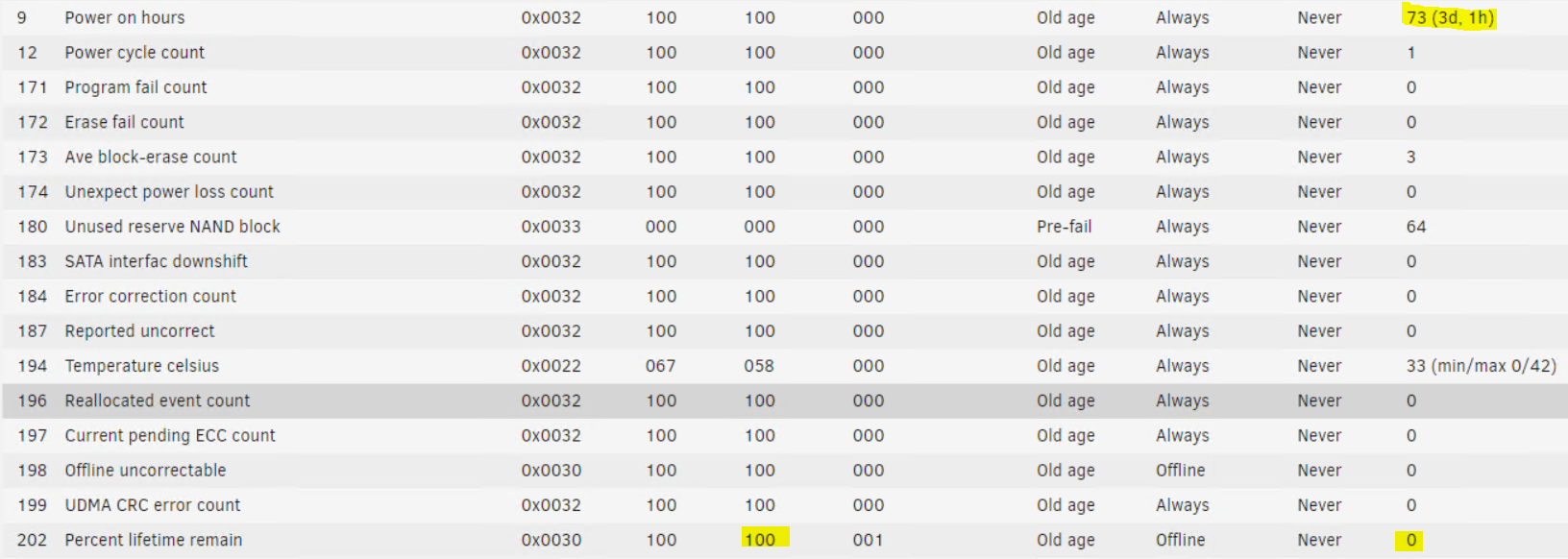

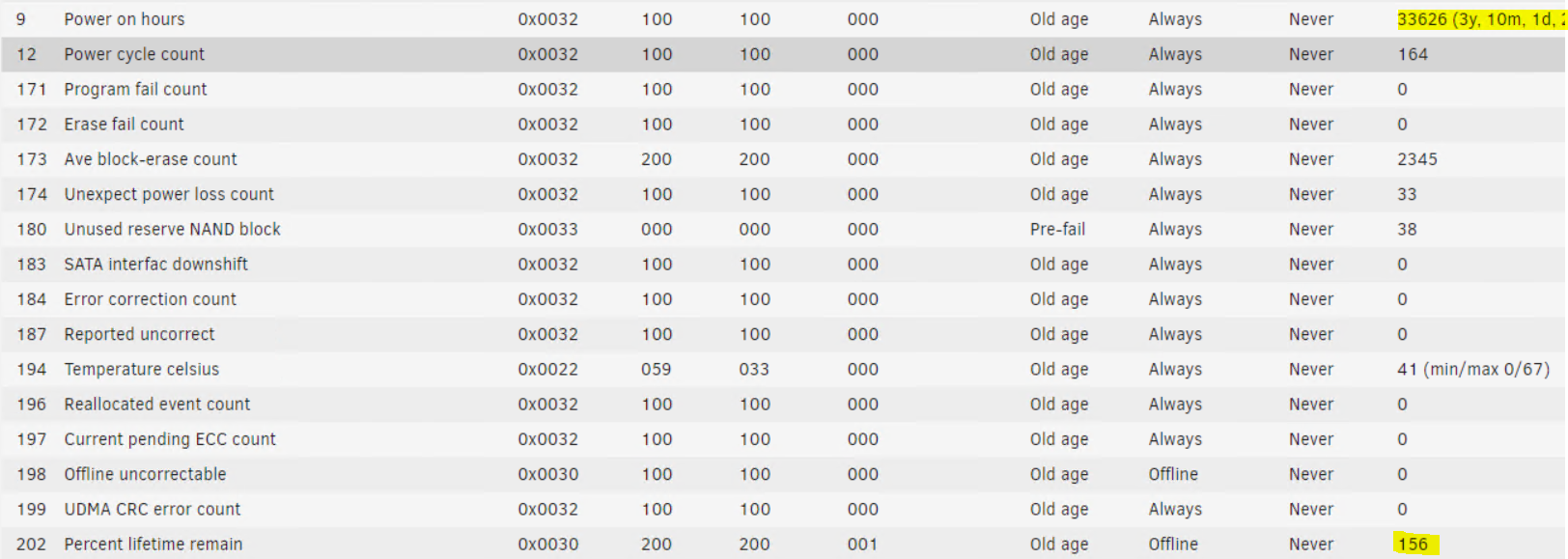

August 2, 20233 yr 38 minutes ago, artkingjw said: I thought 23% is what remains? For this device it's means used, remain is the normalized value, this is form a device just recently added to my server, still at 100% remaining: And this is for the device that's well past 100% Note that the normalized value changed to 200, I guess to not show a failed SMART attribute, since threshold is 1
