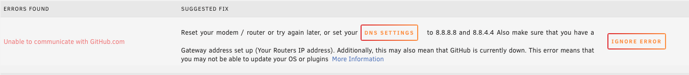

Server offline after changing the pools.
After removing one pool and and making another, the server have some dns problems it seems.
I have not made any other changes.
My local network is working.
Internet access is ok.
The other server is working fine with the same dns settings.
I have restarted the modem, router and switch.
I can connect to the GUI.
The startup sequence show ip address.

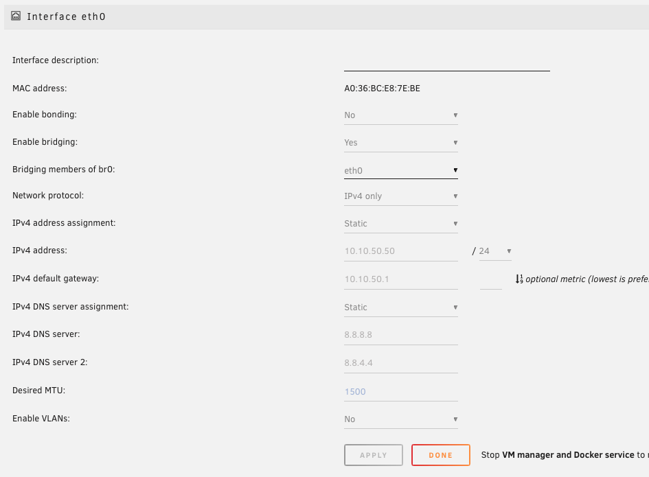

VM on network source br0 on the same Nic as the server is on internet.

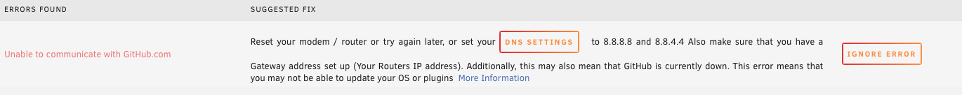

  • When setting up network, see picture, the dns error appeared.

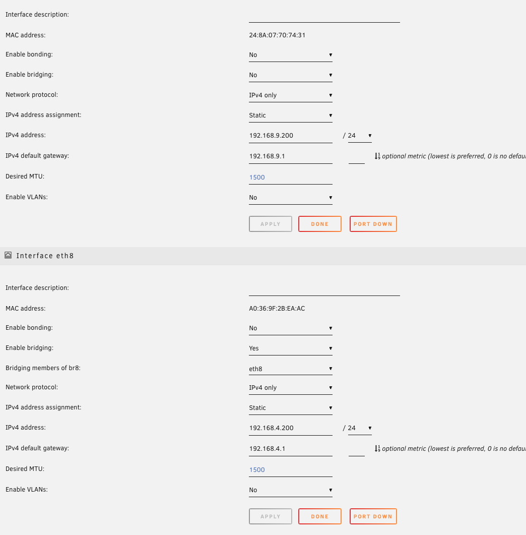

Leave the gateway for the 10GbE NIC blank.
Ok, but not if the interface is connected to a switch? Only when direct connection if I understand correctly?
Same, using multiple gateways usually causes issues.

Not sure what you are asking, I just meant don't use a gateway except for eth0.
