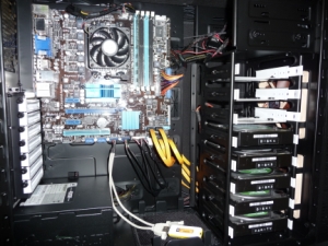

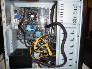

And I would stay away from the Antec 300 solely because of the lack of cable management, check mine with only 5 drives, sure I didn't put much time in with cable management but with 11 drives!
I just 'upgraded' to an R3, but I'm still not totally satisfied, http://lime-technology.com/forum/index.php?topic=2031.540
I should have gone with this, http://www.pccasegear.com/index.php?main_page=product_info&cPath=25_238&products_id=17988 , and I think I still will eventually and the R3 will become the HTPC I've been planning.
However I would mod/cutout the front( under the front cover) to accept 2x140mm fans, this would also allow access to hdd's(after removing fans of course)

It is really hard to pick the correct gear!  I'm sure it is going to tough to get some decent cable management going in the 300.  I didn't think about the sata power connectors on the PSU, but i could grab a couple of the adapters and be alright.
The other pics do look much much cleaner.  Your making it a tough choice for me!
