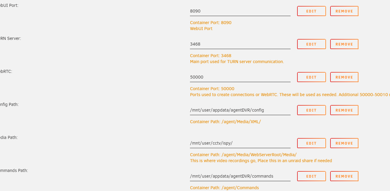

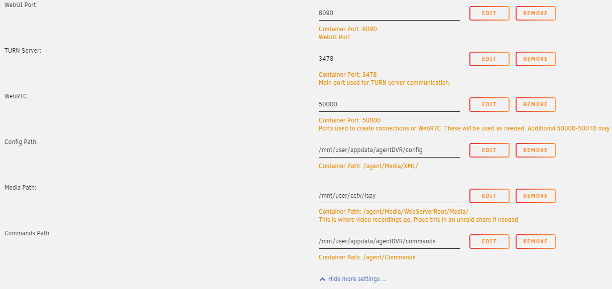

September 30, 20232 yr Well yes and thank you. but i am really more concerned with the 15gb agentdvr docker, I just had the system freeze up I think it filled up the 75gb I had just rebooted the system when I rebooted it was at 15.7 now its at 21gb. I have two machines running the same docker and posted the mapping from both. I just can't figre out what is filling up the docker on that machine. Thanks Chas
October 1, 20232 yr I'm sorry, I wasn't clear. I have 2 machines, there are two mappings posted. the individual setting on agentdvr are the same. One system has 1.57gb docker that doesn't grow and the other has 21gb and growing. I have no idea how to figure out where I went wrong. Chas
October 1, 20232 yr 30 minutes ago, kysdaddy said: I just can't figre out what is filling up the docker on that machine. Container size from the Docker Tab is where you'd begin. Post the screenshot back
October 1, 20232 yr OK I know what the problem was because I recreated it on the server that the image wasn't growing. Agentdvr archive setting. /mnt/user/cctv/spy_archive mapped in the main storage tab. Individual cam storage setting has /mnt/user/cctv/spy_archive but it doesn't seem to be working as when I turned on archive, the docker image grew by 9gb overnight. At this point I can live without archiving the videos, I just need to delete the videos from the docker image? Any chance you can point me in the right direction to find out how to do that? Should I recreate the whole docker image? Thanks Chas
