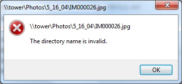

I've attached an error message I got from Windows when I tried accessing a file from one of the shares.  I've also attached an up to date syslog.

I haven't used an Atheros nic myself but it seems the Atheros driver included with 4.x isn't terribly robust. Somewhere between "good luck" and "might work". Your syslog doesn't show anything interesting. Could you grab another after a few failed accesses? Are you seeing any errors at the console? Do you have another nic you could try?
Many thanks to both of you!!!
I installed the same NIC I was using in the previous system and my new system now works great.  Would it be possible to update the Atheros driver so I might be able to use the on-board interface?
