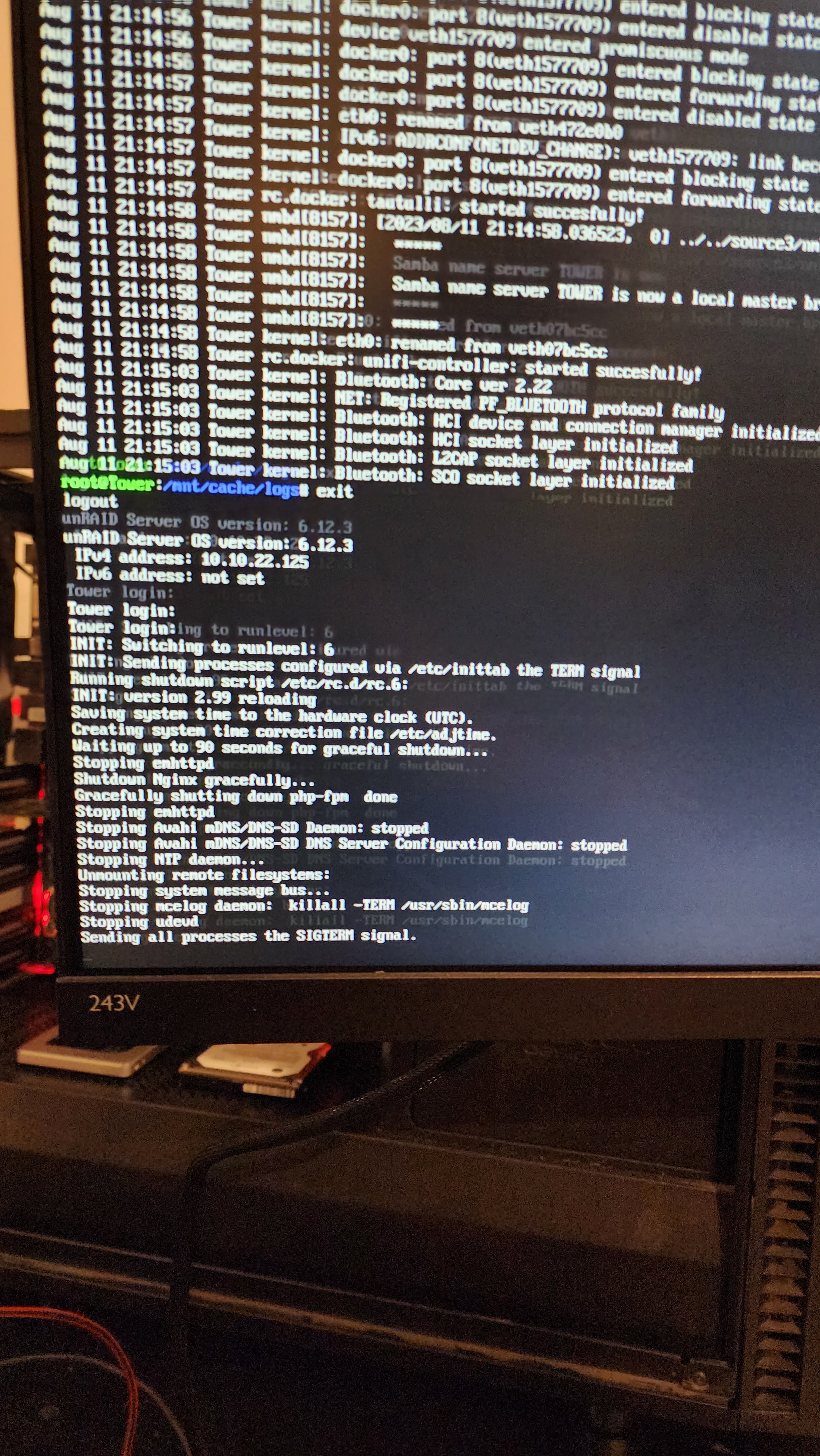

August 11, 20233 yr Author I think I just managed to catch it crashing from the console. Apologies for the crappy photo. I rushed to snap it. After this photo was taken, the server rebooted, the HBA loaded and discovered the attached drives. The BIOS failed to load after that, so nothing else booted. I'm stuck on a blank screen with a flashing cursor.
August 11, 20233 yr Community Expert 56 minutes ago, jdndm said: I think I just managed to catch it crashing from the console. Console shows a shutdown being initiated, this can be done by the OS or a plugin, or a quick power button press. 57 minutes ago, jdndm said: I'm stuck on a blank screen with a flashing cursor. Check that the flash drive is bootable, or redo it.
