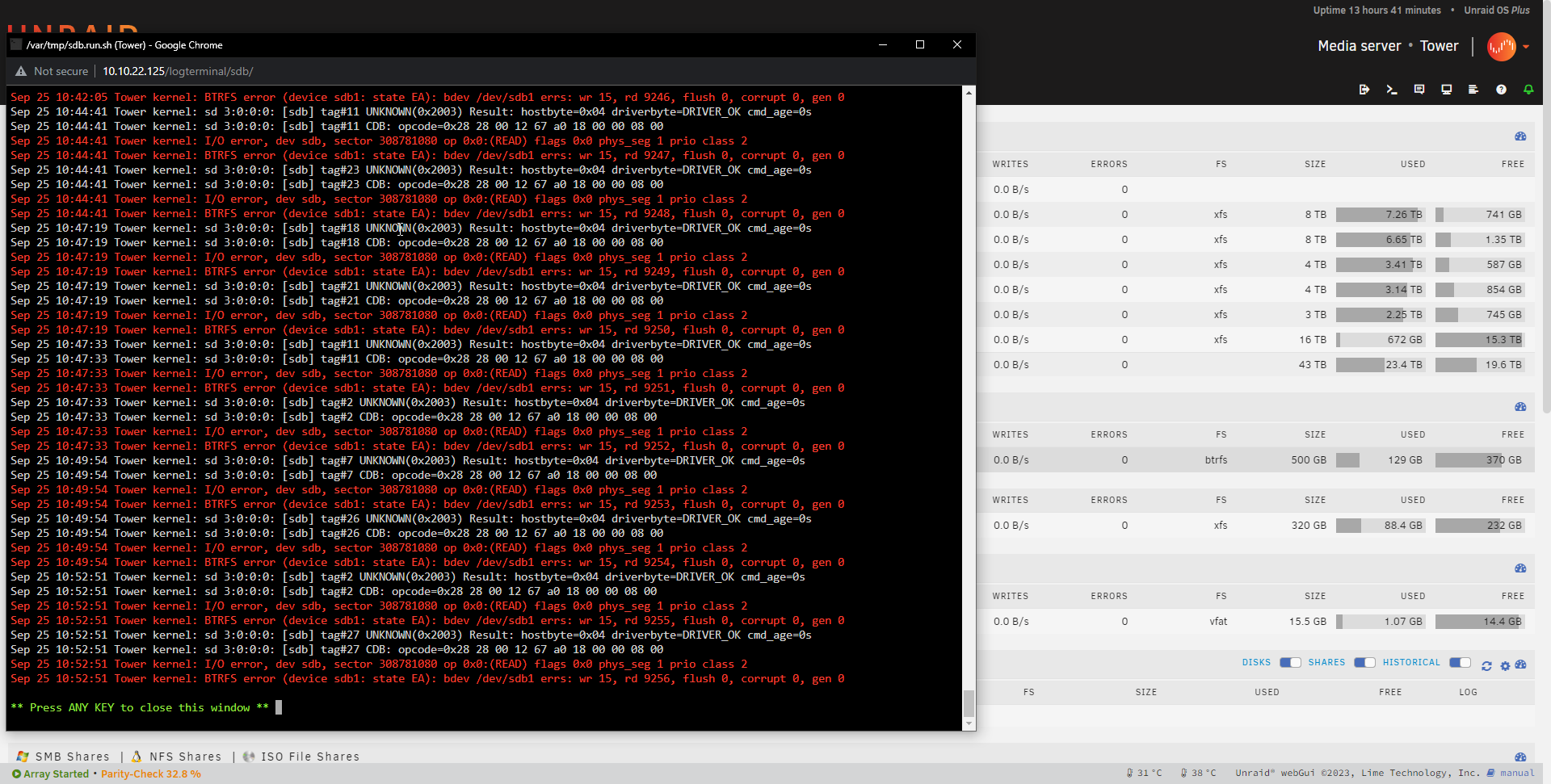

  2. Just had another crash, diagnostics attached. The UI is still up, so if there's any further investigation I can do please let me know. tower-diagnostics-20230925-1040.zip

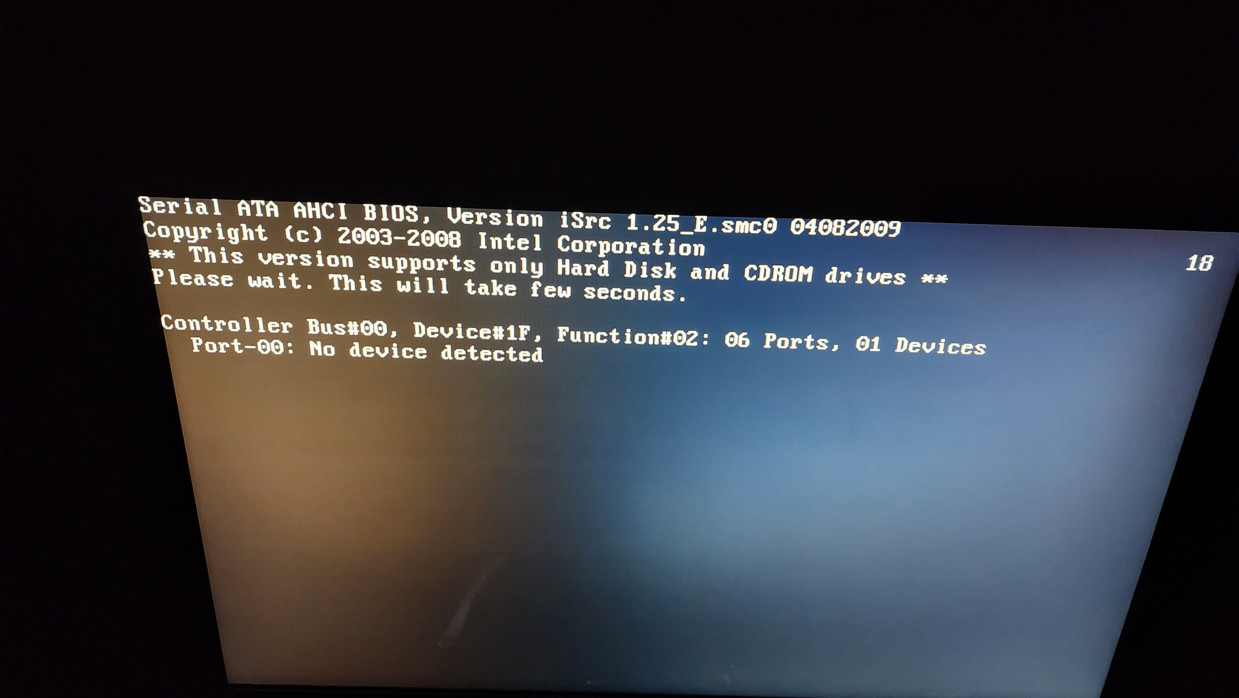

  4. Well since that last shutdown I have been unable to get my system to boot up at all. I now have a "USB device overcurrent warning" and can't even load the BIOS. I've unplugged everything except a single stick of ram, CPU and 1 fan but still no luck. I'm suspect the motherboard has failed. Thanks for your help, but I'm going to have to leave it here for now and hope I have better luck with some different hardware.

  7. I am seeing this in the logs that indicates an error with my HBA. I swapped the slots that my HBA is connected to and the error followed the device. Line 577: Aug 11 10:53:36 Tower kernel: mpt3sas 0000:02:00.0: invalid VPD tag 0x00 (size 0) at offset 0; assume missing optional EEPROM Line 1313: Aug 11 18:55:15 Tower kernel: mpt3sas 0000:01:00.0: invalid VPD tag 0x00 (size 0) at offset 0; assume missing optional EEPROM
  8. Latest crash was around 19:54:43. I've attached a new diagnostics and syslog that is saved to the array. Below is the logs around the latest crash, I removed a bunch of `ACPI action...` logs that were flooding the logs. They were caused everytime I pressed an arrow key on the keyboard. I attempted to connect to the console after the crash to download diags / logs but no luck, so I don't think the logs are as complete as they could be.. Aug 11 18:44:45 Tower webGUI: Successful login user root from 10.10.22.110 Aug 11 18:46:24 Tower kernel: docker0: port 8(vethe89368e) entered blocking state Aug 11 18:46:24 Tower kernel: docker0: port 8(vethe89368e) entered disabled state Aug 11 18:46:24 Tower kernel: device vethe89368e entered promiscuous mode Aug 11 18:46:24 Tower kernel: docker0: port 8(vethe89368e) entered blocking state Aug 11 18:46:24 Tower kernel: docker0: port 8(vethe89368e) entered forwarding state Aug 11 18:46:24 Tower kernel: docker0: port 8(vethe89368e) entered disabled state Aug 11 18:46:24 Tower kernel: eth0: renamed from veth7fadde6 Aug 11 18:46:24 Tower kernel: IPv6: ADDRCONF(NETDEV_CHANGE): vethe89368e: link becomes ready Aug 11 18:46:24 Tower kernel: docker0: port 8(vethe89368e) entered blocking state Aug 11 18:46:24 Tower kernel: docker0: port 8(vethe89368e) entered forwarding state Aug 11 18:55:15 Tower kernel: mpt3sas 0000:01:00.0: invalid VPD tag 0x00 (size 0) at offset 0; assume missing optional EEPROM Aug 11 18:52:51 Tower root: ACPI action up is not defined Aug 11 18:55:27 Tower root: ACPI action down is not defined ... ... Aug 11 19:02:23 Tower root: ACPI action right is not defined Aug 11 19:12:40 Tower emhttpd: spinning down /dev/sde Aug 11 19:12:42 Tower emhttpd: spinning down /dev/sdh Aug 11 19:12:42 Tower emhttpd: spinning down /dev/sdg Aug 11 19:12:42 Tower emhttpd: spinning down /dev/sdd Aug 11 19:12:42 Tower emhttpd: spinning down /dev/sdf Aug 11 19:54:43 Tower emhttpd: spinning down /dev/sdb Aug 11 21:14:32 Tower root: Delaying execution of fix common problems scan for 10 minutes Aug 11 21:14:32 Tower unassigned.devices: Mounting 'Auto Mount' Devices... Aug 11 21:14:32 Tower emhttpd: Starting services... tower-diagnostics-20230811-2140.zip syslog-10.10.22.125.log
