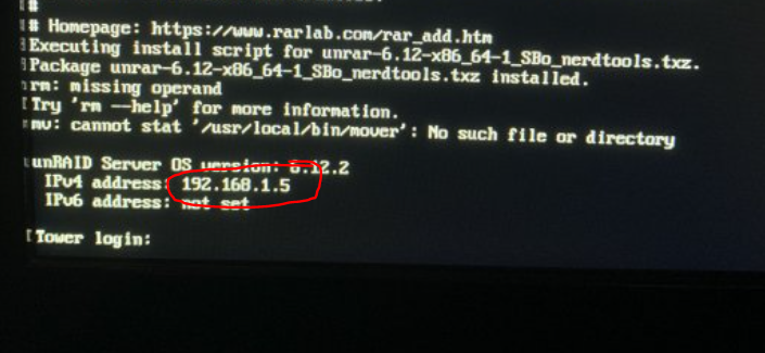

You should now be able to access the server from another computer using a browser, point to the server IP or name.
You can see the assigned IP on the monitor:
That means the server is not getting an IP from your router, you can get and post the diagnostics so we can check the NC link.
