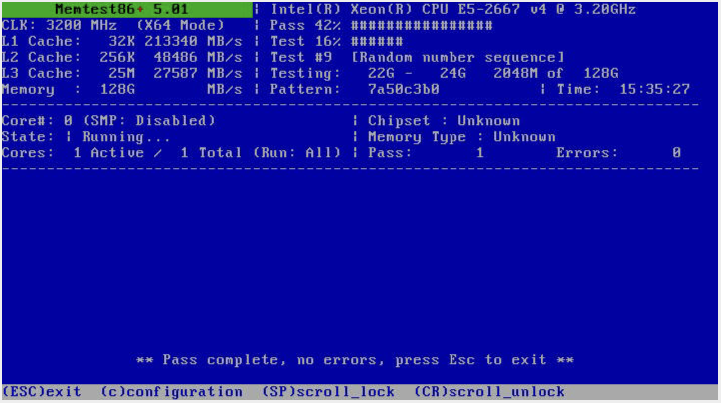

I’ve looked in IPMI and the syslog has zero errors logged and while unraid crashes IPMI stays up.  It crashed again today and the NVME drives were removed and had VMs off because of that. So it’s not NVME or VM related.  I’m currently running a mem test and I’m half way through it with no errors.
Edited by SmallwoodDR82
update.  Had another crash on Monday.  Ran memtest.  All Passed.
