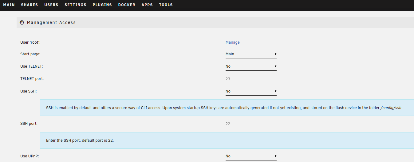

August 21, 20233 yr Community Expert Solution In Settings >>> System Management when you turn the 'Help' on (the icon of the right side of GUI), you will see this bit of information: As I understand this, it says that the SSH is 'on by default' and the keys will be generated automatically if they are not found. So if you do not want SSH keys generated, You need to set 'Use SSH:' to "No". You could then delete the keys.
