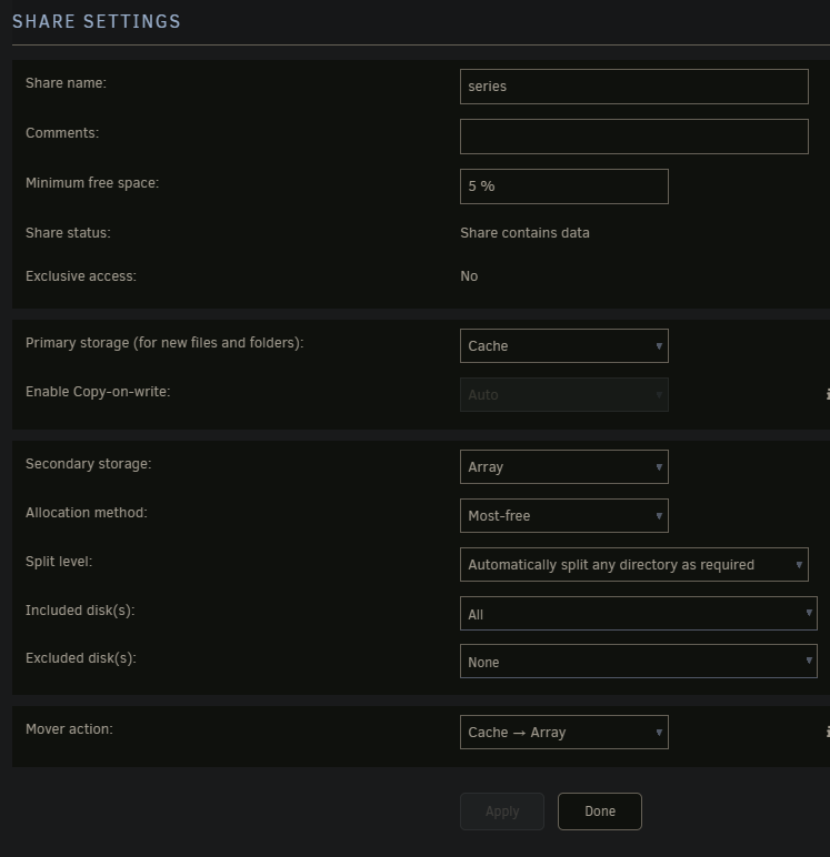

Which filesystem?
all of them are zfs. do you need other informations?
For zfs Unraid creates a dataset for shares, so they are in fact a different filesystem, and because of that will always require a rewrite.
Reads for the other array disks are normal if you have turbo write enabled.
Do you have Turbo Write enabled?

Nothing much you can do, if you just wanted to change the share name that is easy and instant, but this is normal when moving data from one dataset to another.
Well, I want to reorganise the share... also move files and root folders to subfolders (inside the disk)...
So there is no chance to get this faster? Usually, a move takes seconds, and I must wait hours to move files inside the same disk.
this seems to be the trade-off from zfs...

AFAIK not unless they are all inside the same dataset (share) or it can just be renamed.
I can move it inside of the share and then rename it.
So, in the end, this should be fast if this happens on the same disk and in the same share?
You can only rename the top level folder, which is the dataset.
Sorry, I get confused a bit...
Does this mean movement is still slow even if I move folders and files inside of the same share/dataset?
Moving files to the same disk inside the same dataset/share is fast.
