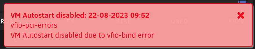

I just started the array and this error popped up again:
The logs show this:
Error: Vendor:Device 1b73:1100 not found at 0000:02:00.0, unable to bind device
That device ID is not listed in the system devices. So I am not sure what it is.
Edited by Aidzer0
Delete that entry from /boot/vfio-pci.cfg.
Legend, thank you, that worked. Also, I just rebooted the system 3 times in a row without failure.
I do not know what was causing the issue but it is resolved now. (It was not the bind because it successfully rebooted before I removed the binding)
