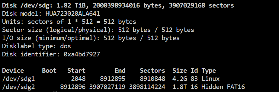

I'm trying to mount an HDD to pull pull some old footage from a failed CCTV DVR.
I need to mount sdg2. It's reporting to be a Hidden FAT16 partition type.
I've tried:
mount -t vfat /dev/sdg2 /mnt/disks/dvr-HDD
and get this error:
mount: /mnt/disks/dvr-HDD: wrong fs type, bad option, bad superblock on /dev/sdg2, missing codepage or helper program, or other error.
       dmesg(1) may have more information after failed mount system call.
Also tried:    mount -t msdos /dev/sdg2 /mnt/disks/dvr-HDD and get the same error.
Disk may be bad. Any ideas?  Thanks.

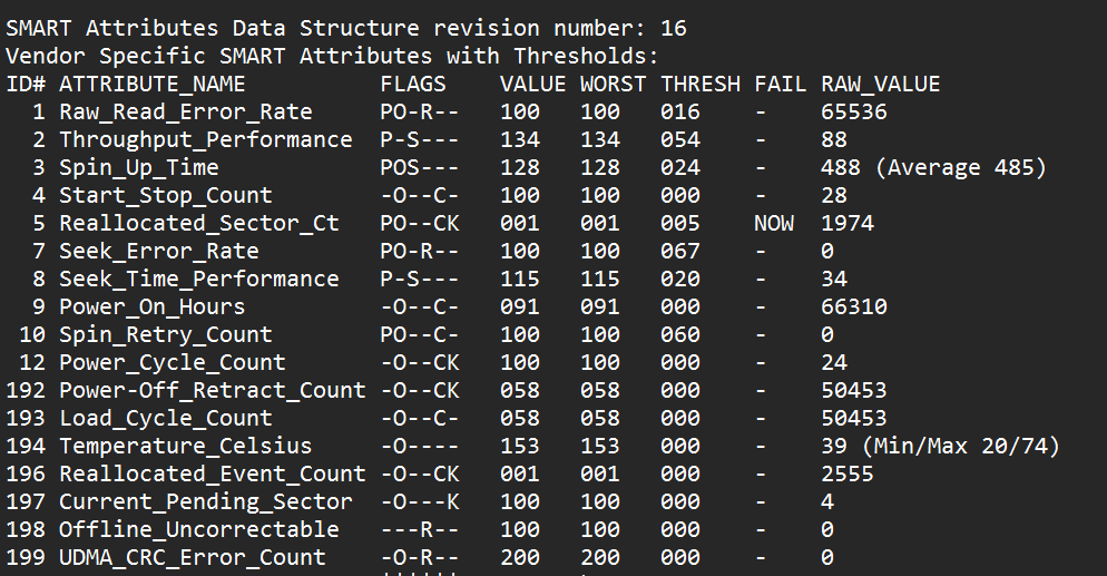

Update:  Well, looks like it's failing but can i still mount? lol
Edited by adminmat
Bumping up. Any ideas ?
Post the syslog after an attempted mount, but even without any i/o errors the disk may be the problem.
