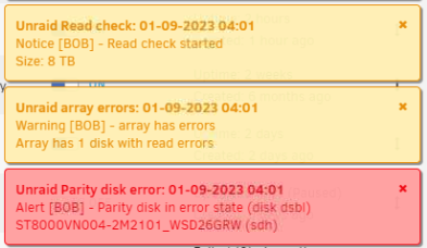

My monthly parity check started at 04:00 and when I checked on the server when I woke up I was greeted by these messages

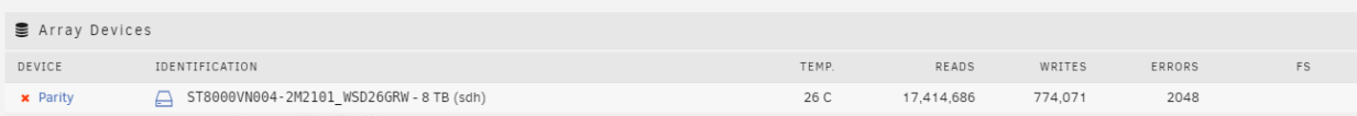

And this is what Array Devices shows

Not sure from the diagnostics if you have a drive problem or not.
I would suggest that:
  • You check the cabling (SATA and power) to the drive in case one of them is not fully seated.
  • Run an extended SMART test of the drive (accessed by clicking on the drive in the Main tab).   It takes ~ 2 hours per TB so is quite lengthy.    If it fails that drive should be replaced.
Report back here for next steps if the SMART step is error free.
