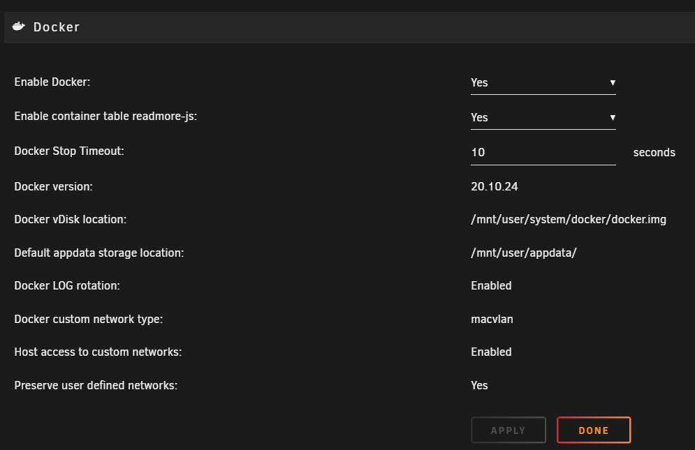

Docker seems to not be able to communicate outside the docker network after several problems i had initially when upgrading from 6.11.5 to 6.12.3.
I have a bit of a special setup:
I have a fritzbox 7590 as router with dhcp disabled. it's Ipv4 is 10.10.10.1 with the subnetmask 255.255.0.0
I have a raspberry pi with adguard home running - it acts as my dns server and has dhcp enabled. Its Ipv4 adress is 10.10.10.2 and gives out ip adresses from 10.10.100.1 to 10.10.100.255
My smart home devices have all set ip adresses in th range of 10.10.11.1 to 10.10.11.255
Home assistant runs as VM and has the ipv4 10.10.11.1
My unraid server has 10.10.10.10
I have a windows 11 VM with 10.10.10.11
I have several docker containers (nextcloud, guacamole, home assistance and others) which run all as bridge and are accessible from their respective subdomains.
While nextcloud, bitwarden and others work fine, Guacamole works semi (I can load up guacamole as service but can not connect to my VM) and home assistant just gives me a 502.
To my understanding the common thing here is that the docker containers seem to be unable connecting outside the dockernetwork itself. (at least that's how i would be able to explain why guacamole loads up fine but i can not connect to a vm and home assistant does not work)
This is my docker config:
image.png.984f54bc52d782440f6f5fac605c5b29.pngimage.png.3c34bc6d95e058dd5a52667dac158cee.png

So to my understanding swag should be configured correctly but the docker network seems to have a slight "hickup".
Just to clearify the log is with the correct domain not mydomain.com.
Also the VMs work fine when connecting to them within my own network or via vpn (windows can be loaded up via rdp) Home assitant can be accessed via 10.10.11.1:8123
Can someone please help me out? Thank you all so much!
Solved by Zeze21
Unfortunately the update to 6.12.4 did not change anything
I still get a 502 Bad Request when trying to access home assistant via the web
Ok the solution was simple the dockers i wanted to connect to the rest of the Network had to be in br0 mode. Hope anybody who has the same issue finds this helpful
