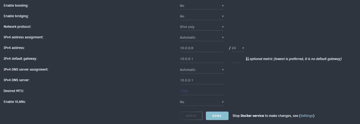

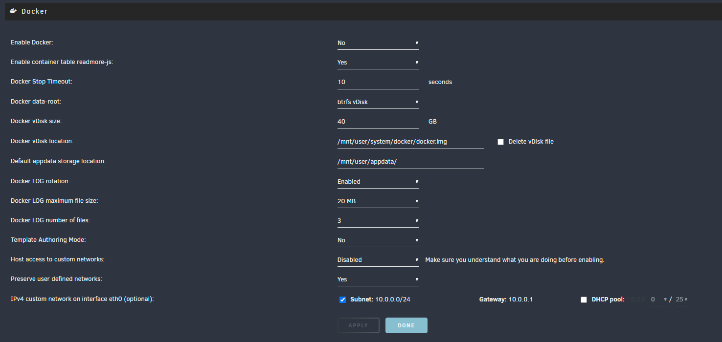

@ljm42 These are my current settings:
I will enable bridging, and make sure the system is ipvlan.

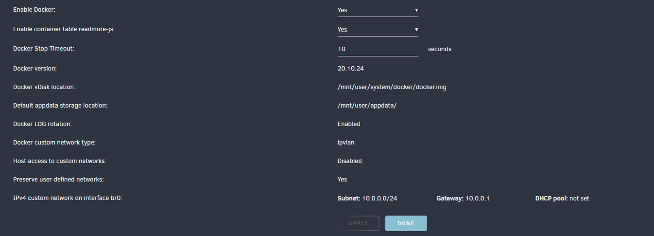

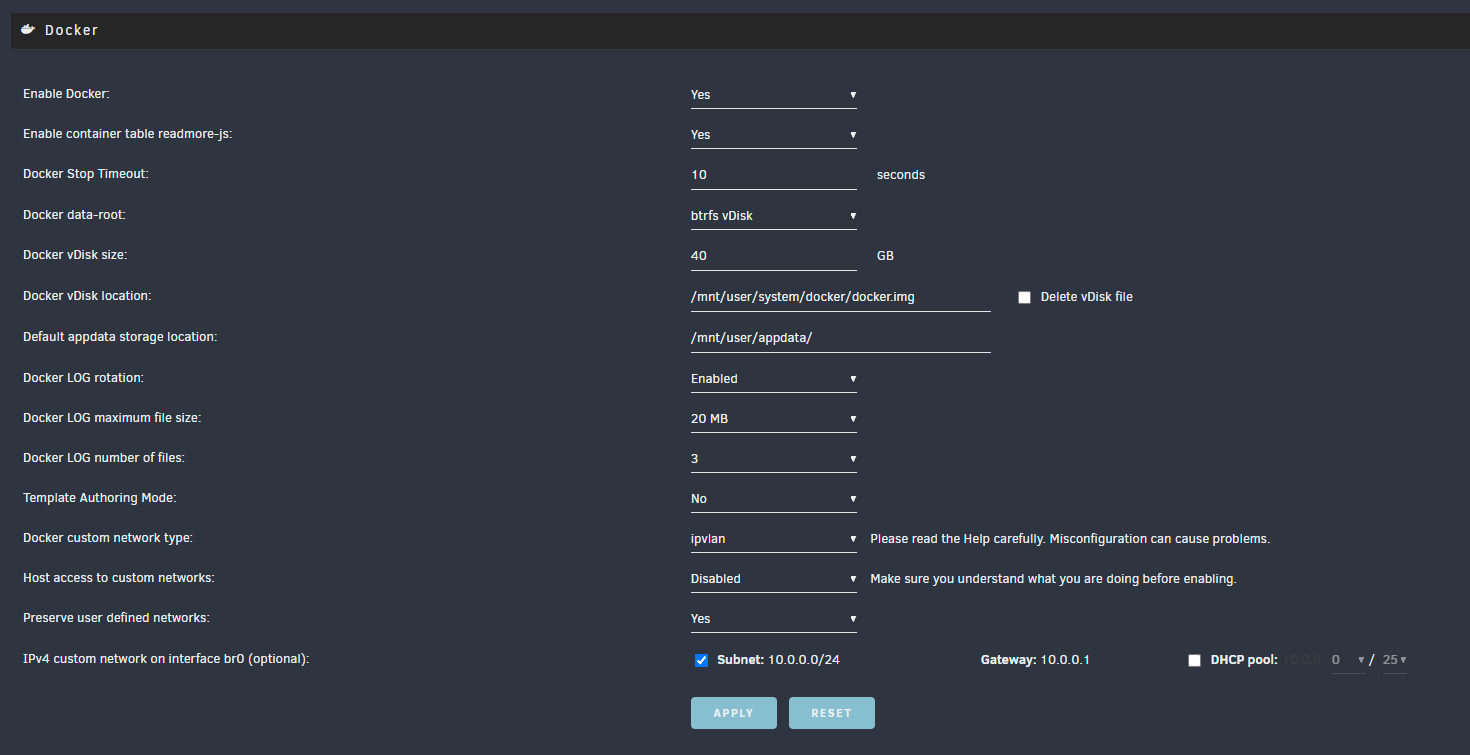

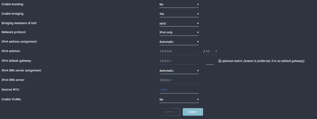

After:
Post reboot:
