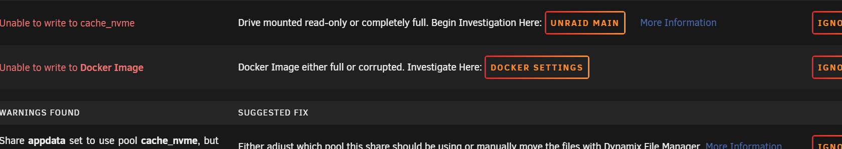

I am unable to access my dockers some are stop other show running. Either way I cannot access them or stop or start them. If I reboot I can access them for a couple of minutes. Under fix common problems shows this. Also attaching Diagnostics Thanks. The cache_nvme drive is where the dockers are stored and it is not full.1363323932_Screenshot2023-09-05182152.thumb.png.b9b2ec8ee20154234eff96624506c00d.png

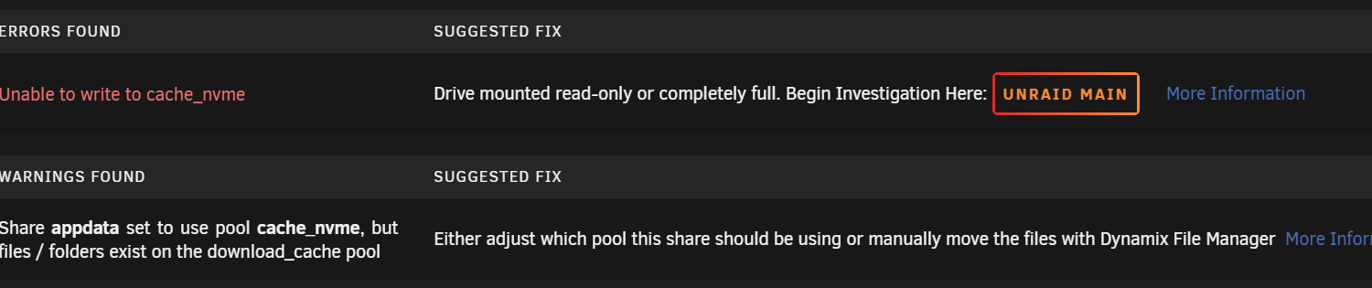

Thanks for the help. So I ran the test and Got errors right way so I pulled one 16gm stick left the other one in now the test is showing no errors but same issue. Fix common problems now showing this: drive should not be ready-only and is not full currently at 78%?
Cache filesystem is corrupt, you should backup and re-format, also a good idea to run memtest.
