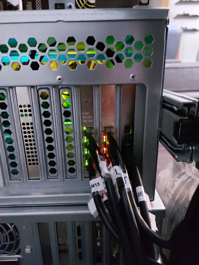

Here's a picture of the nics, the right one is passthroughed to pfsense and the left one is all of a sudden giving me a problem.
Edited by joelones
Seems like a power cycle brought back the nic's activities LEDs, not sure what happened. could be I'm on an old (currently overloaded) UPS so maybe power issues, i hope not hardware.
