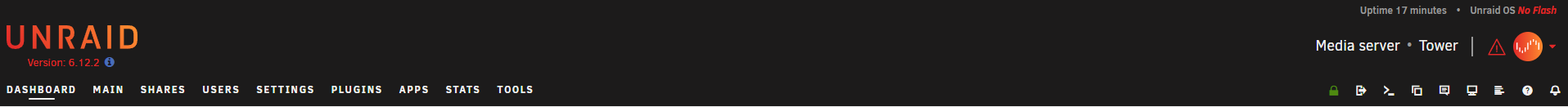

I just replaced my usb key, because I restarted the server 2-3 times this morning because I still had the usb key error. I restart the server now I'll see if the error comes back quickly.
I replaced the USB key and I still have the message
Try rebooting, the Connect plugin can take some time to show the correct key status.
I was able to activate the USB key, that's not the problem. The issue is that after a few minutes, the key seems to disconnect from the server as if I had removed it. I switched the USB port to see if I still have the problem.
The syslog did show flash drive problems, if replacing the flash drive doesn't help it's likely a USB problem, try a different port, ideally USB 2.0.
