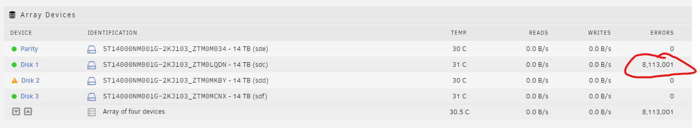

I'm rebuilding the data on the errored drive now.  There isn't a better way correct?  You have to rebuild after a "drive error event"?
Well that's not good.  This is after starting the array rebuild.

Attach NEW diagnostics to your NEXT post in this thread.
Similar to the previous issue, not that I really suspect the LSI but since you have unused onboard SATA ports I would connect all the disks there and retry to rule that out, if issues persist PSU/power connections would be the next suspects.
