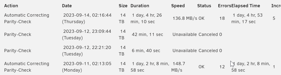

Follow up question. Every time I crash and the parity check starts it detects 12 sync errors. Are these errors getting corrected and new every time or are then always the same?
thanks
It depends on whether the check that is running is correcting or non-correcting.   Since you have the Parity Check Tuning plugin installed the entries in the Parity History should tell you what type of check was run.
I see. So in this case I guess that the errors are corrected and are generated again when the server crashes.
