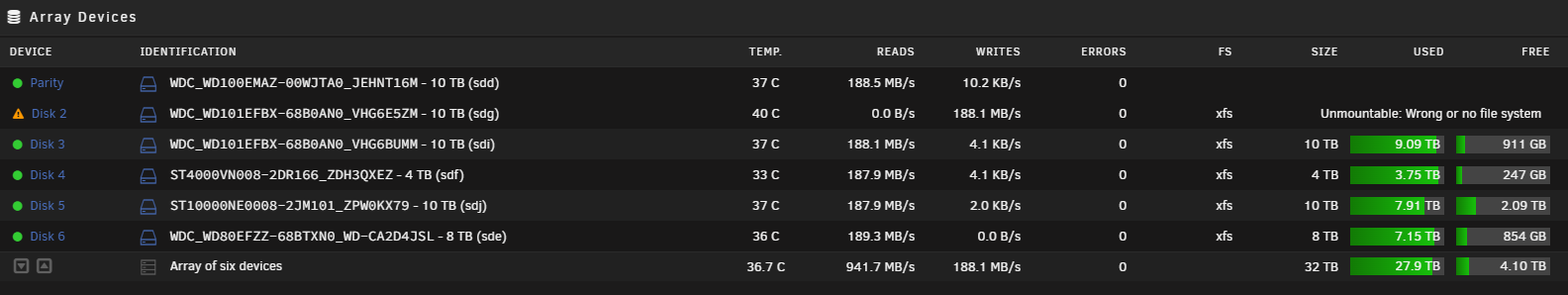

Disks however show my disk2 saying Unmnountable: wrong or no filesystem.  disk2 for me is part of media share with the movies only.
Check share - no movies, only TVShows - everything on non TV shows disk is gone.
No problem I thought - I have a hotspare 10TB drive in the system, stopper array, moved that into place, started aray, parity rebuild.
But - horribly, it is building the 'faulty disk' data to it - i.e the emulated contents are nothing.......
What did i do wrong here ?  Should I have done something different ?

OK - I read up on this now - thanks @trurl.
I guess I have been using unraid for so long (8+ years) without ever having seen this, so I rushed into it.
I was supposed to stop the array, start it in maintenance mode (never had to do that before), and run the check and repair of the xfs disk.
