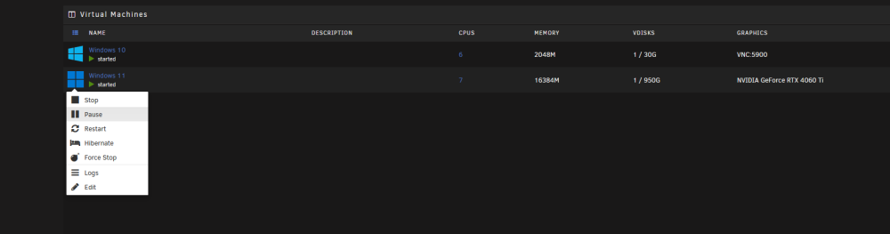

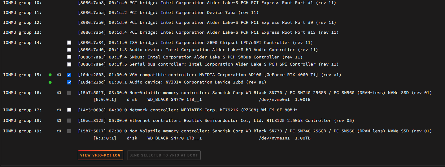

Hello there, I followed SpaceInvaderOne's video on dumping VBIOS for Windows 11 VM. I have VT-D enabled on my MSI Motherboard (i9-12900K). Everything is working, I have my Graphics card enabled through the system devices and it shows up when setting up the Windowsdows 11 VM. The only issue is that there is no place to select VNC when clicking on the VM. It works with the Windows 10 Vm that I also have set up but that is with a virtual graphics card so I know that It is a setting to do with the actual 4060 TI.
Upon plugging in a monitor to the Graphics card I saw that it was also getting help on on this error - VT-D Active for GFX Access. I looked through a few Unraid support forums and ran these two command to get that issue fixed.

You will not get vnc option as you only have physical gpu allocate. Change primary to virtual and gpu as secondary to load drivers etc
