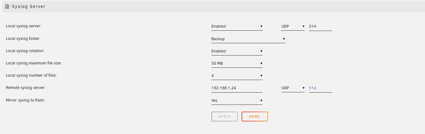

I enabled remote syslog and started logging to my desktop, will see if it records anything on the next crash/hang. I wish Unraid would store logs on flash so it would survive the reboot.
It will if you enable the Mirror to flash option in the syslog server.
Mirror option was already enabled but didn't seem to capture crash details on diagnostics log unless it gets stored somewhere else on the flash. It crashed again also after enabling remote syslog but remote log entries showed nothing out of ordinary prior to crash, just bunch of kernel messages regarding usb connect disconnect events for the mouse.
The file is in the ‘logs’ folder on the flash drive.
