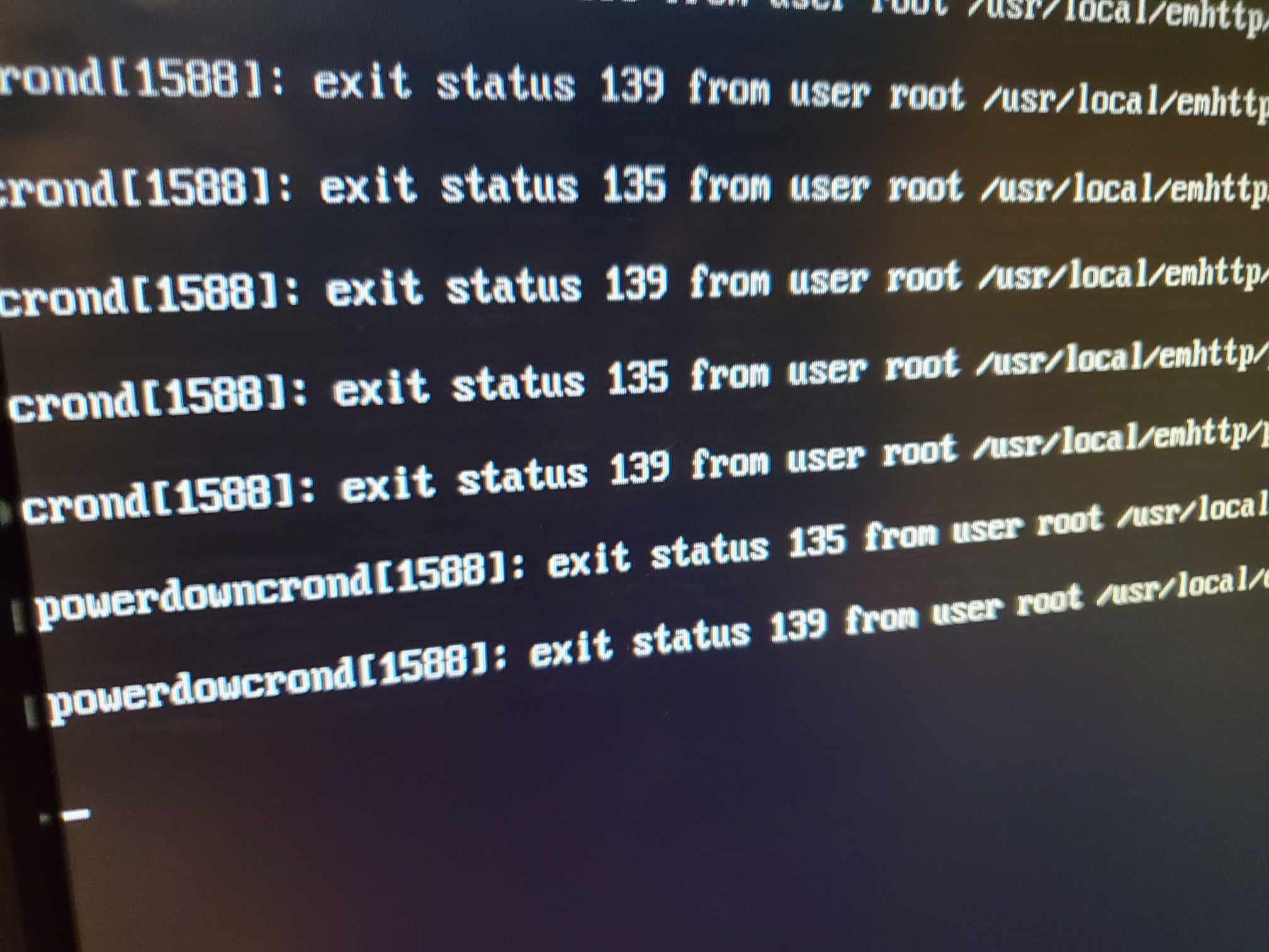

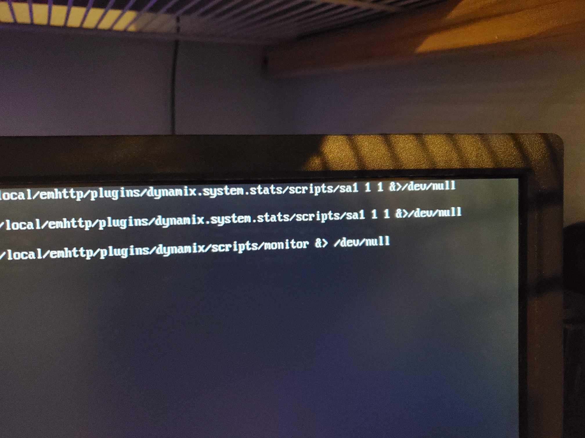

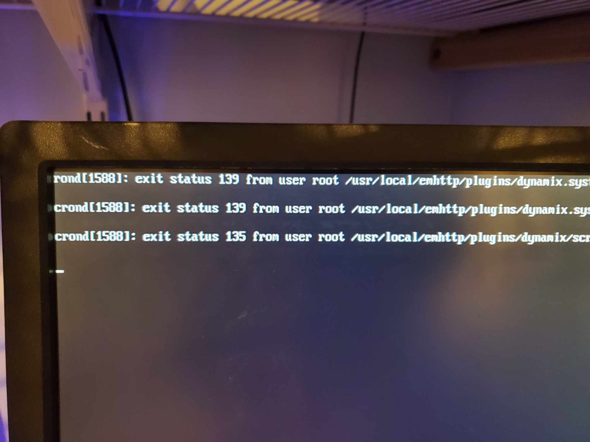

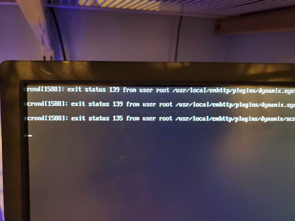

September 18, 20233 yr As of last night at midnight, all was fine. I got my array status notification. But sometime after that my server crashed. I can't get to webGUI or SSH. The errors on the monitor connected to the machine keep coming up every few seconds or so. See images below that my wife sent me (I am away at the moment). I asked her to try to log in so she could shut it down via command line, but the errors popping up keep interrupting her login. So, first question....is this a memory issue? Seems from some short googling that may be the case. I've ordered more RAM just in case. Second, should I just pull the plug and abandon a graceful shut down? [EDIT] - I just noticed this error in one of her other photos right after she apparently successfully logged in: -bash: /usr/share/bash-completion/bash_completion: Input/output error Thanks! Edited September 18, 20233 yr by Mattaton
