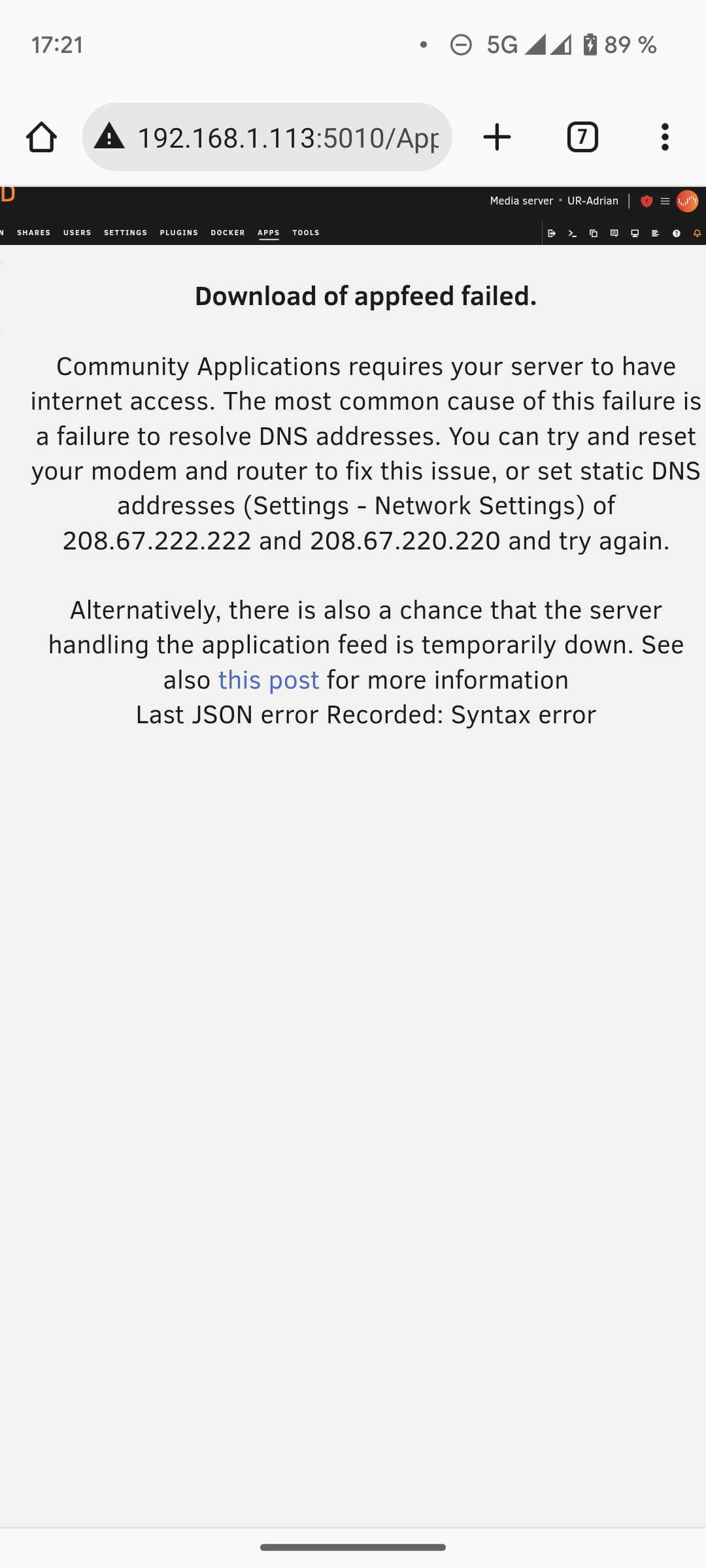

after a cold restart of my unraid server (safeguards off), my unraid server does not reach the DNS server anymore, resulting unraid web offline (NETWORK: getaddrinfo ENOTFOUND mothership.unraid.netCLOUD: Socket closed), Dockers cannot be checked for updates and so forth.
Logs are attached, but what can I do in order to restore it?

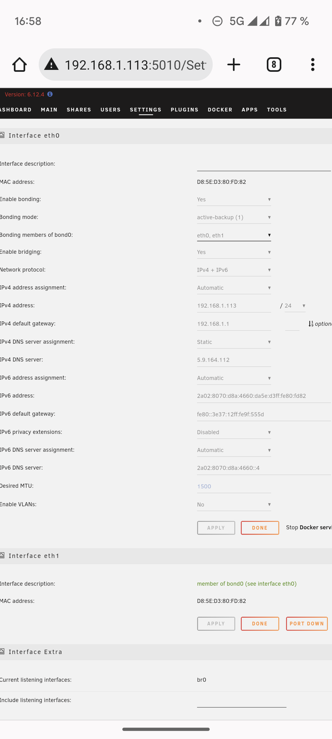

Duh, stupid me, its probably DHCP doing it. Anyway the dns server on 5.X.XXX.112 is dead

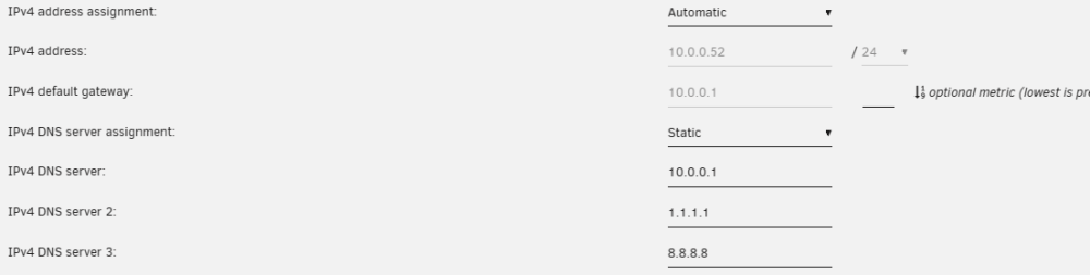

Where to add the server twice?
Try adding 1.1.1.1 or 8.8.8.8 as dns in unraids networksettings and see if that fixes it.
The Server under 5.X.XXX.112 doesnt seem to have a dns server running
In settings, I can only set up one ipv4 and ipv6 DNS server
you have to set it to static
Or change the DHCP Server settings to not hand out the 5.x.xxx.112 server as dns server.
I set it to static and the DNS server is a valid server which responds if you ping it
