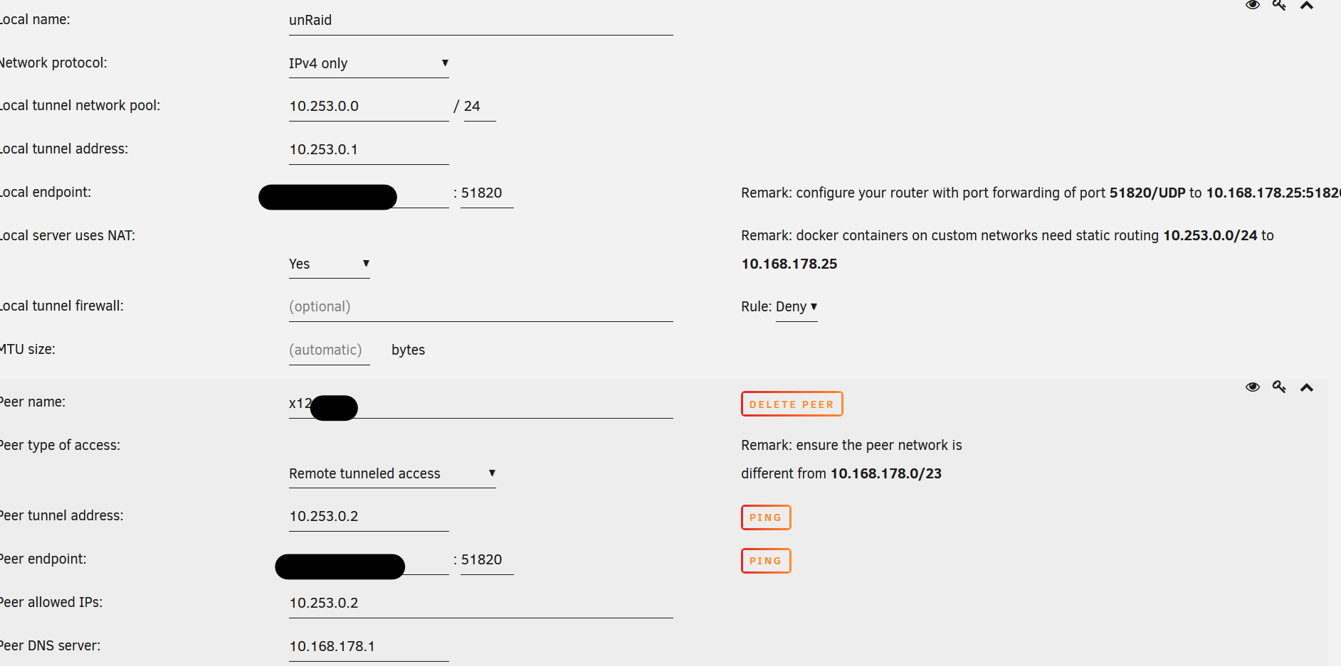

I use Wireguard with remote tunneled acces. I can connect to my unraid Server but the Docker Apps wont load the Web UI. This affects all Docker Containers set to bridge mode or br0. In LAN I am able to open the GUI with all of them.
I put a static route in my router, but I am not sure if that was done right. I guess not. Maybe anyone here could help me out? 1ß.168.178.25 is the IP of the unRAID Server

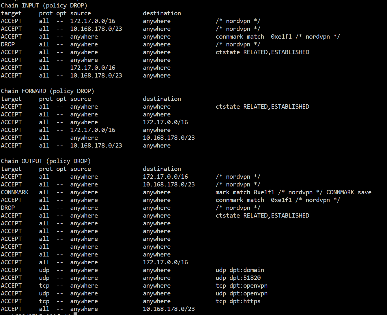

here the iptables from the nordvpn docker
Edited by pille
working again. Had to change the 10.168.178.0/23 to 10.0.0.0/8
