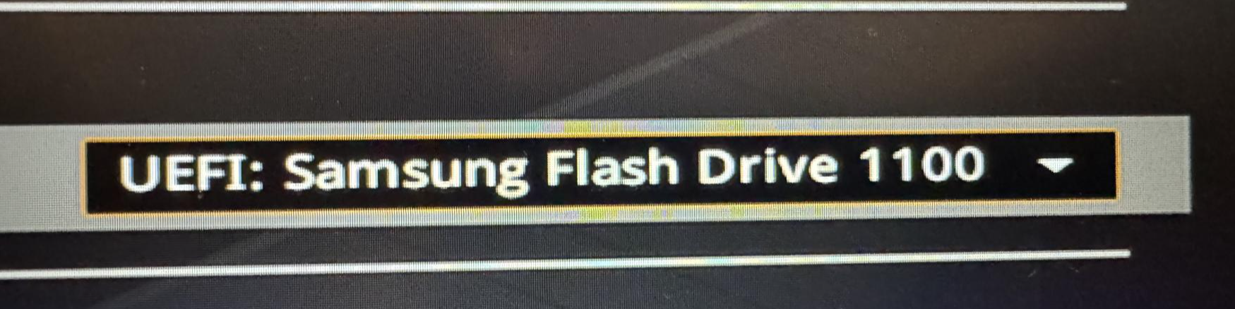

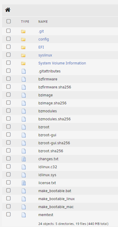

I have googled and read posts about people with similar issues but their tricks are not working for me. Basically what the title says, when I safely restart via the dashboard nothing but a black screen displays and I can't reach the web UI from another machine. When I do a hard reset I get the UEFI Bios press F2/DEL to enter window which I can jump into. My motherboard is an ASUS TUF Gaming Z790-Plus WiFi D4. My USB stick is a Samsung BAR Plus 64GB I used the unraid usb flash creator on windows and Allow UEFI boot was checked (it's defaulted to checked). The folder also appears to be named correctly, here is the root of the drive:
On the front page of the UEFI BIOS the USB stick shows right up and you can select it and boot into it:

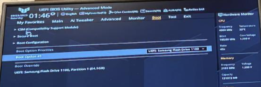

In Advanced Mode which is really just the BIOS it's the only option you can select as a boot device:
Fast Boot is disabled, I was really hoping that would do the trick but I still got stuck on the black screen after saving the change and restarting. I then had to do a hard reboot to get back to UEFI BIOS and select the disk to book things back up so I could check that folder name on the flash drive and make this post.
