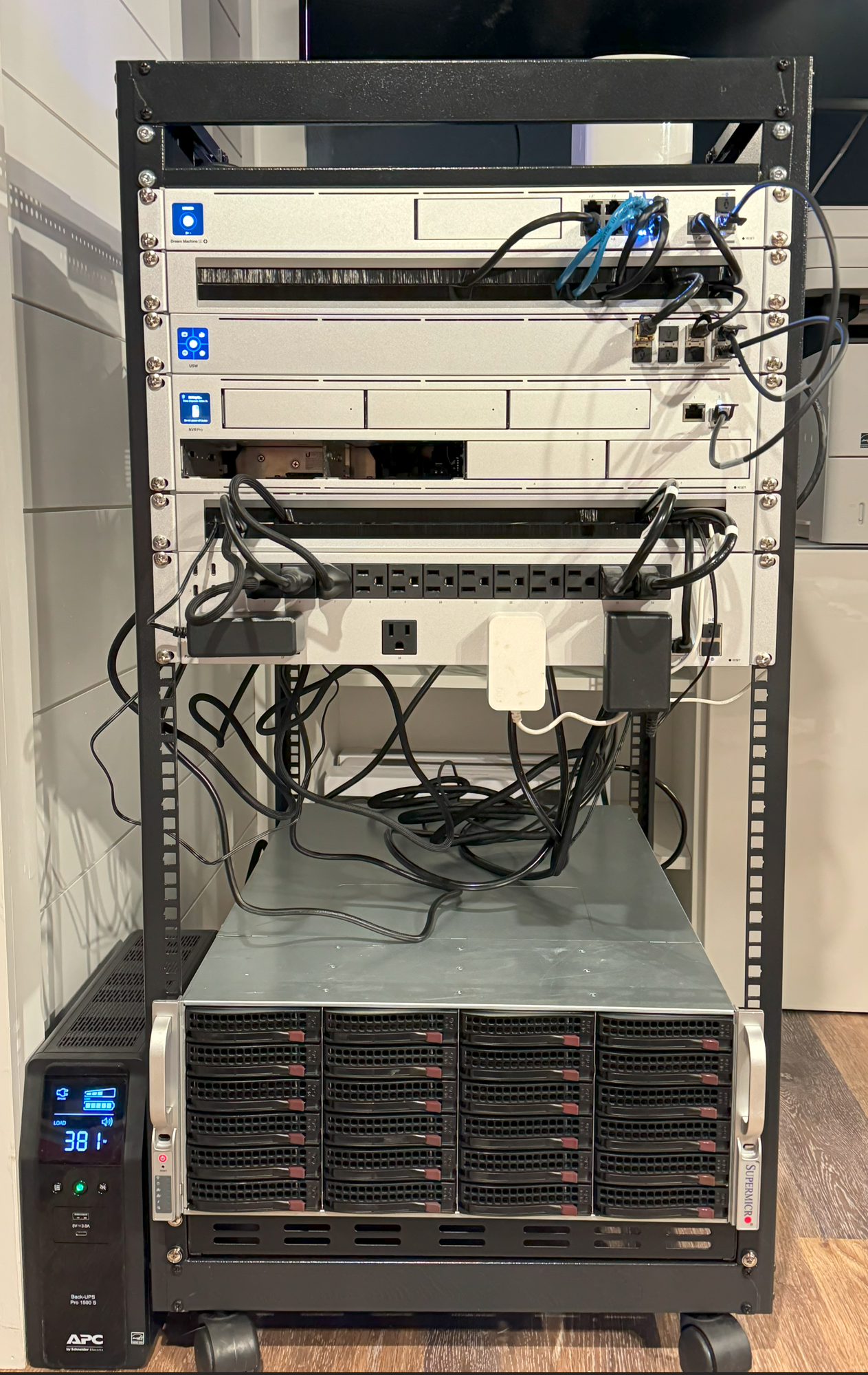

SuperMicro CSE 847 36 Bay 4U SAS 3 Barebone Chassis 2x PWS-1K28P-SQ
I made the switch yesterday! I was quite nervous because my server was very stable and gets a lot of use but thankfully it was smooth sailing. All I needed was one LSI Broadcom SAS 9300-8i and a low profile CPU cooler. My temps are great, CPU idling at 35 right now and no disk is any higher. On full speed the fans that come with this beast are turbines but I had been using the "Fan Auto Control" plug-in and after configuring that for the new fans it quieted down quite a bit. My server is in utility space so some noise doesn't hurt anyone but if it was in living space new fans would be needed. I also happened to have enough four pin fan cable splitters & extenders on hand to get them all plugged in (7 chassis fans + CPU fan was more than my motherboard could handle). I was able to build out my temporary rack a bit more and it doesn't seem overly strained. I'm not using the rails yet as it's not sturdy enough for those but I have them ready for when I move. For now it's sitting on a diesel shelf. Will need some blank panels to hid the wires but it took me all day until ~2AM yesterday to get this far...
It may be running up against the limit, it was dirt cheap and says 500 lbs "max load bearing" on eBay. Not sure what it is when it's on wheels. Not really sure how to weigh the servers but I'd say the current build is around 100 lbs. Didn't think the 4U would add too much more weight until I added more drives and I'd be putting it at the bottom. Other than that I was going to put a dream machine special edition and a NVR pro on it. For the new house I was going to get something like this: I think I can have it delivered to the garage and then have the movers put it at the termination point of our ethernet cable drops. After assembling the little one I don't really want to assemble a 300lb one...

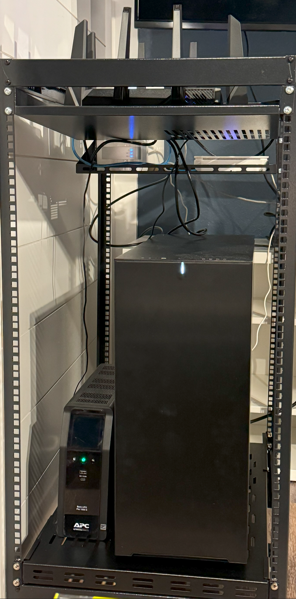

Thanks! This was great information, I think I have a plan on what exactly to do. I'll be moving in 9+ months when construction is done and plan to have a 42U rack at the new place. Starting with some networking equipment tomorrow I'll be provisioning what I can before I move. Will totally grab one of these, my Define 7 XL doesn't fit great in the small rack I grabbed to stage everything...
