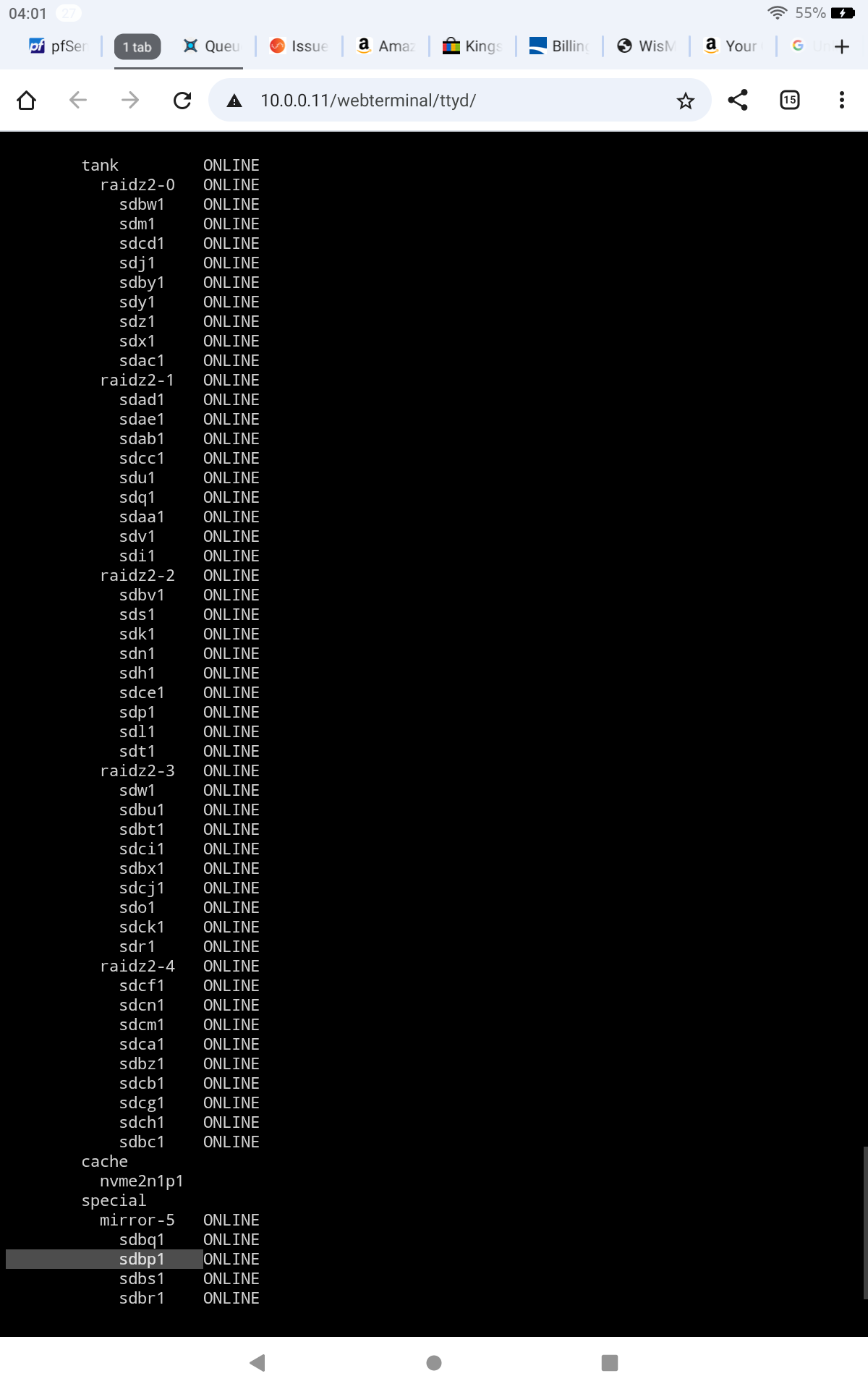

  2. There are multiple pools, all disks show online, its the special vdevs for pool tank that are preventing the array from starting
  3. There are 94 disks on this server, unfortunately I'm on a tablet and can't copy and paste the full output, but I screen shot what I thought would be the applicable part of the output above, if there is another area of the output you want to see, please let me know and ill screen shot it. But output shows all disks online and I don't see anything suspicious

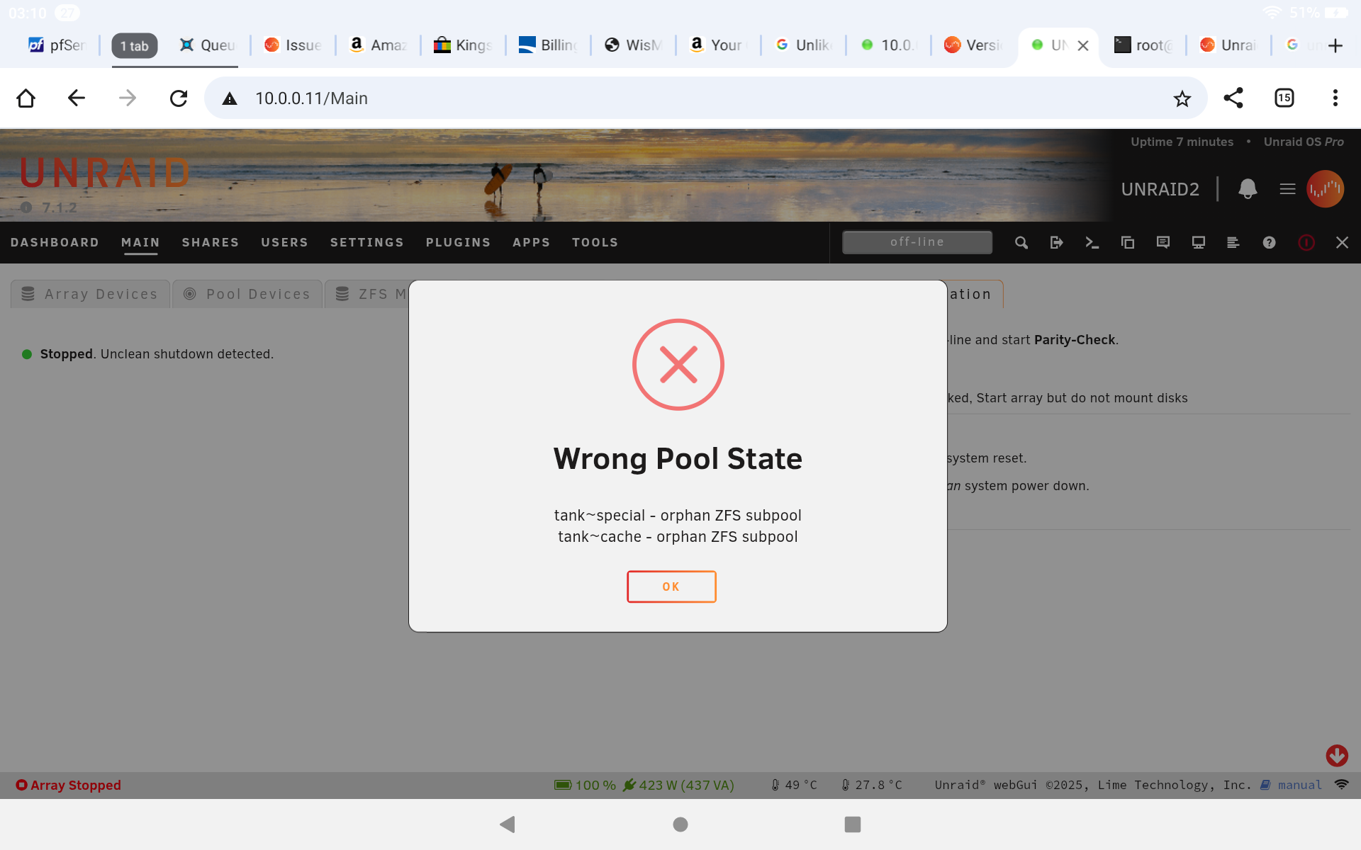

  4. For some unknown reason unraid lost all my pools, the names were all there, but all were set to one device. I recreated all the pools in the Pool devices page, did a zpool import, and still get an error starting poool. Zpool status shows all pools online including tank~special and tank~cache Array won't start. Any ideas?
  5. Thanks, that was it. Working now
