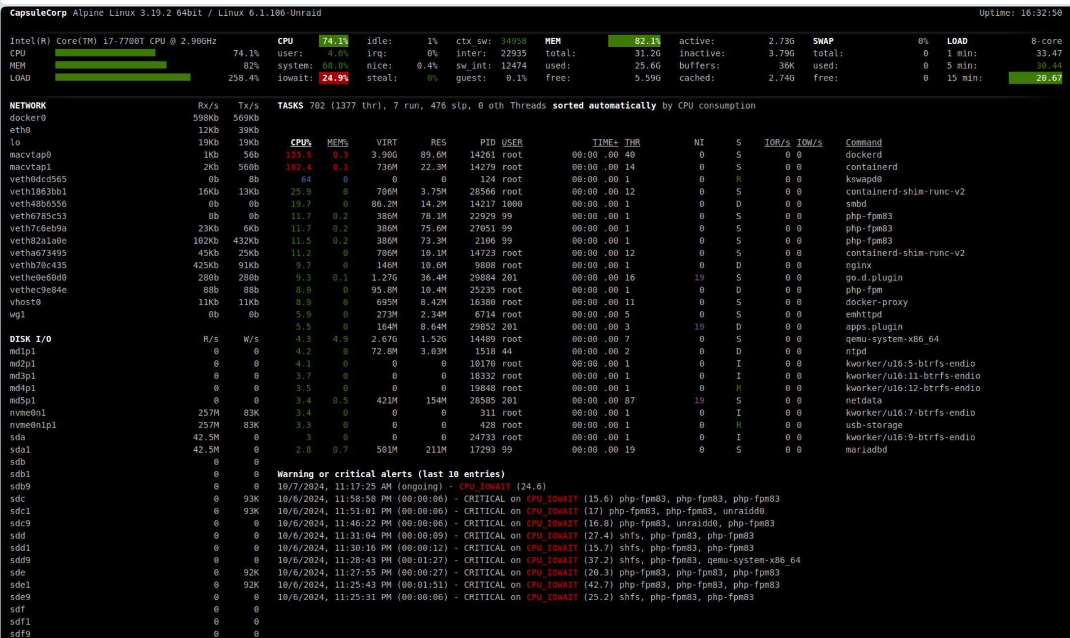

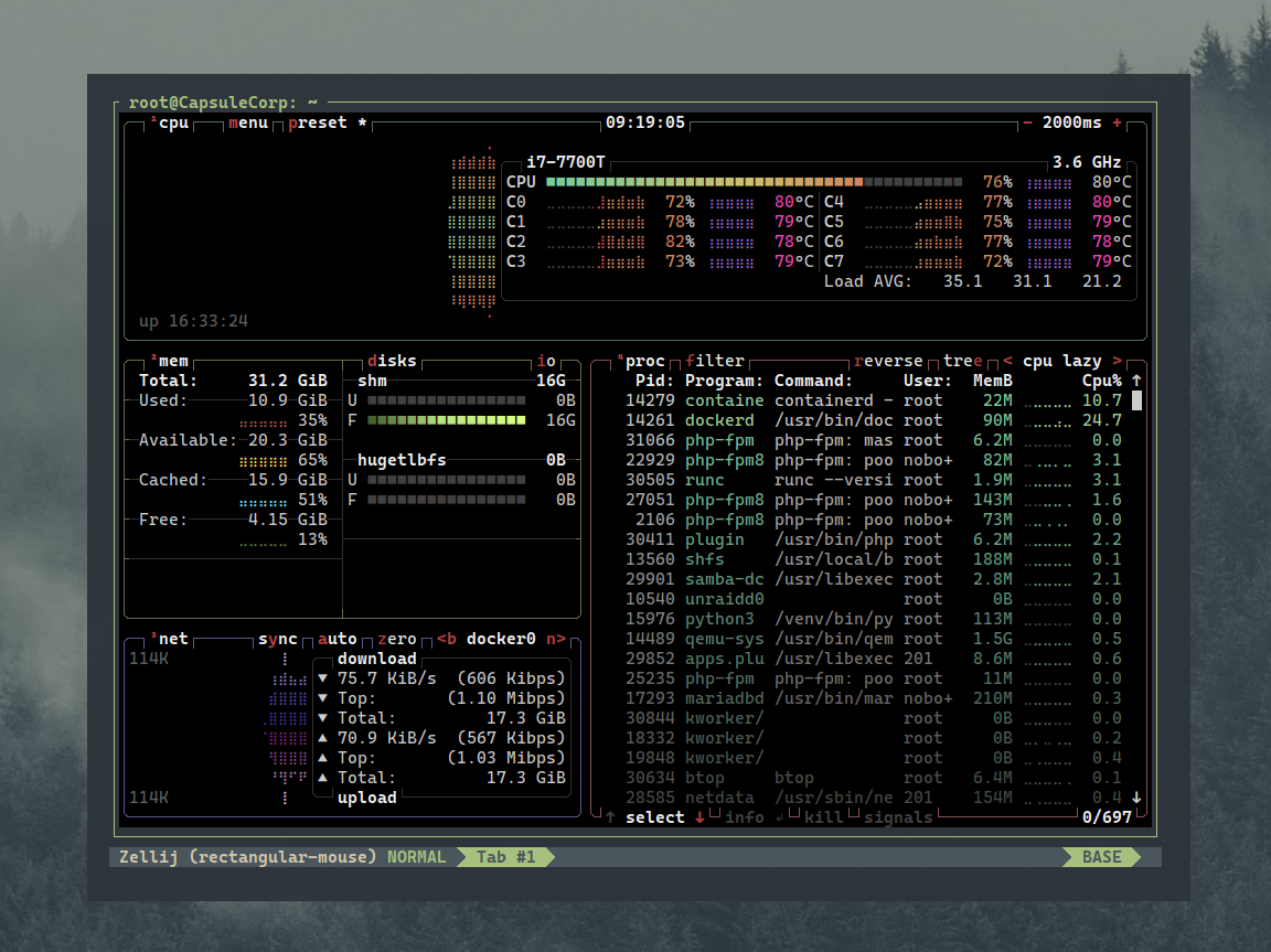

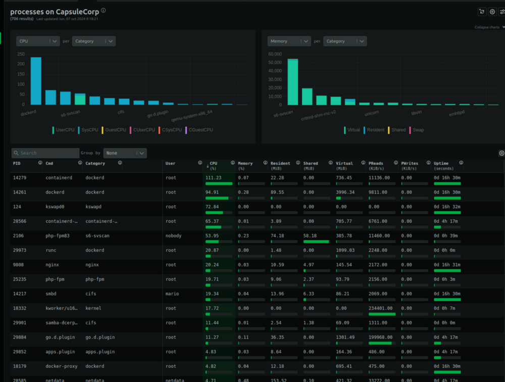

Before the system goes to a total freeze it allows me to connect via ssh and some containers are still working, so I got some output from btop.  Also raised a netdata and glances docker instance and here's the output.... I have absolutely no idea where else to look at.

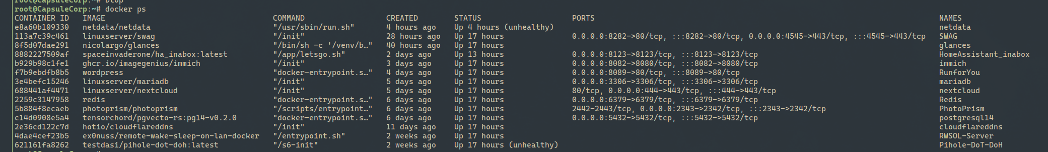

In Glances, at certain point it stops listing docker containers, I managed to execute docker ps via ssh and there are a couple "unhealthy" instances but after a while it is completely impossible to do anything... Even when sending the power off signal I still need to manually disconnect the whole server. I am completely lost with this :(

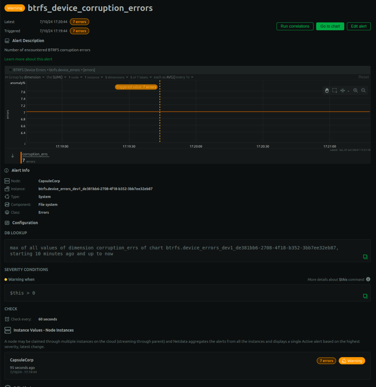

BTW, I see this error from netdata: "BTRFS device corruption errors = 7 errors"
Post new diags.
Oh thanks a lot! might if I ask how did you guess it was corrupted?
Already did the fix, hope it works fine from now :)
Difficult to say, but if it happens again soon there may be an underlying issue.

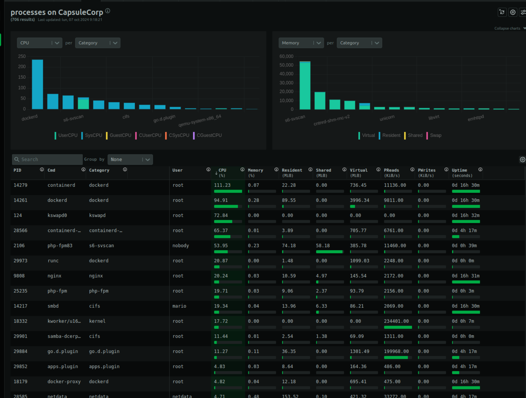

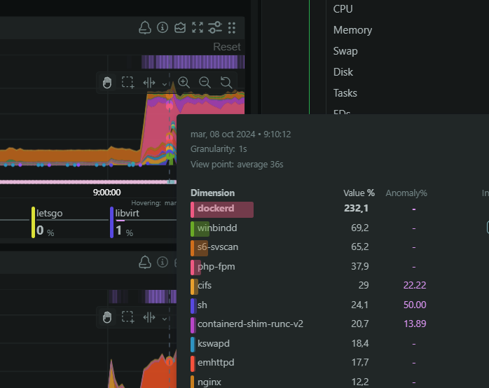

CPU consumption for dockerd goes above the clouds:
Unfortunately there's nothing relevant logged, this can also be a hardware issue, one thing you can try is to boot the server in safe mode with all docker containers/VMs disabled, let it run as a basic NAS for a few days, if it still crashes it's likely a hardware problem, if it doesn't start turning on the other services one by one, including the individual docker containers.
