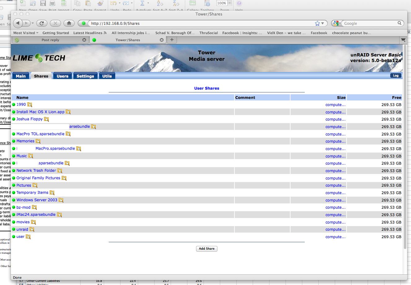

here is one of two

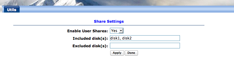

here is two of two
Please show the detailed config of the share used for TM.

Set up a user share for time machine. Select (TimeMachine) in the AFP drop down and turn SMB off. Make a user that TM will use to log in.
It is inadvisable to use disk shares with AFP. Make a user share that only includes the single disk.

2. on the Settings page I go to Share settings and enable user shares with included disk(s) = disk1

Okay I think I have a handle on it now.  In the older version I had two shares "disk1" and "disk2" that corresponded to each disk.  I backed up a bunch of macs to disk1 and disk2.  Then I upgraded to 5.0beta12a.  All the shares showed up when I turned on the user share on disk1 and disk2.  So now under settings share settings I have 'yes' and one disk 'disk1'.  then the shares tab pops up and I create a new share called 'user' that is just 'disk1' with the TimeMachine export option.  I can now map my macs to user.  However Snow leaopard backs up just fine but OS Lion gets the error "The back was not performed because an error occurred while copying files to the backup disk.  The problem may be temporary.  Try again later to back up.  If the problem persists, use Disk Utility to repair your backup disk".
