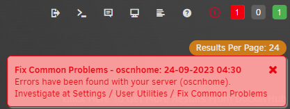

Hello everyone, I recently found this error message on my unraid.
Since I do not use it very often, I did not find information about Mcelog plugin, I decided to come here to ask if anyone can point me to what
went wrong and how to solve.

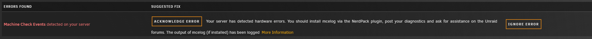

Your server has detected hardware errors. You should install mcelog via the NerdPack plugin, post your diagnostics and ask for assistance on the Unraid forums. The output of mcelog (if installed) has been logged.

Sep 22 15:56:35 oscnhome  mcelog: failed to prefill DIMM database from DMI data
Sep 22 15:56:35 oscnhome  mcelog: Kernel does not support page offline interface
Nothing to worry about, but a BIOS update might silence.
Also, FWIW every 30 seconds from 192.168.1.43 there's a login via SSH that gets logged.  Very annoying to try and isolate any issues because of the constant logging due to that, and this will ultimately fill /var/log and cause issues
In fact, the problem was resolved after I upgraded and changed the MotherBoard. Therefore, the statement about the error being related to the bios makes sense.
