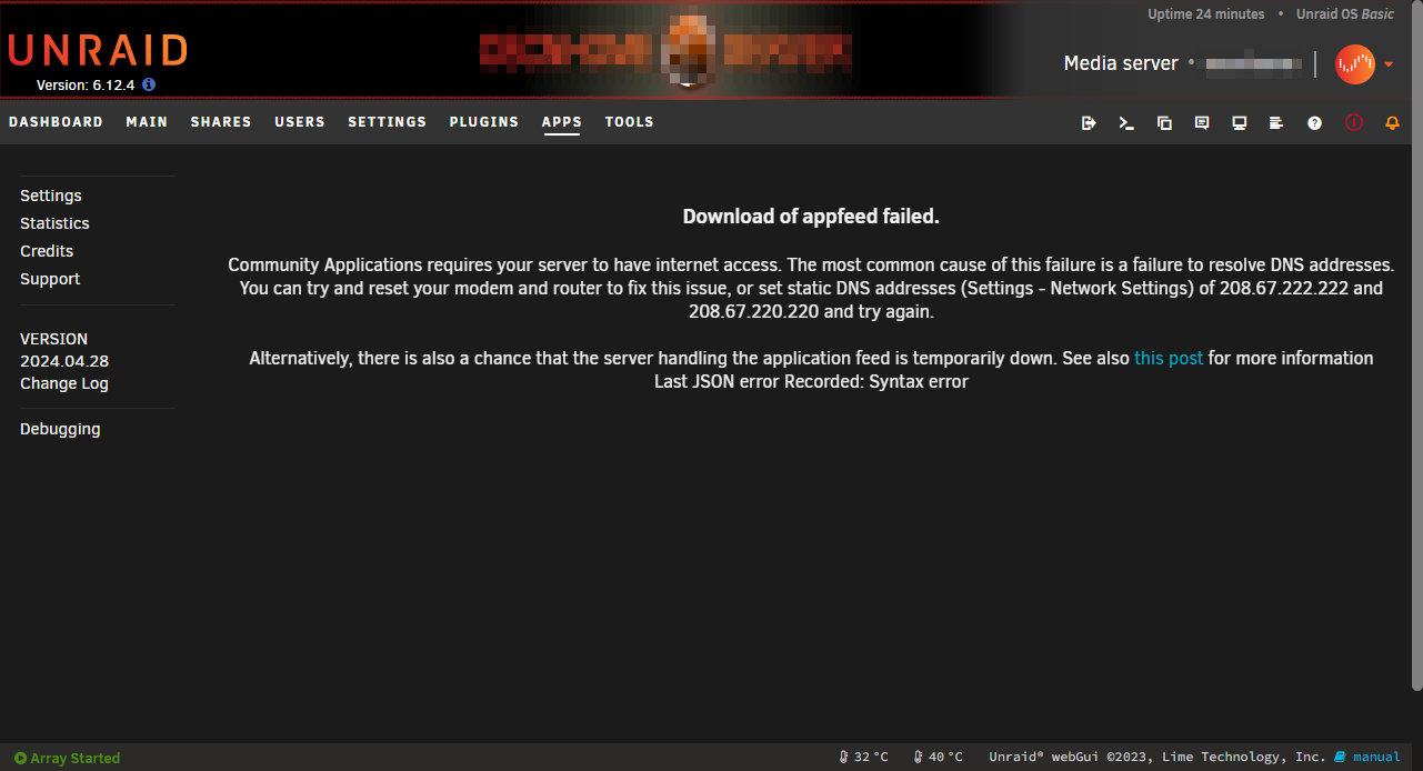

  1. Hello, I am experiencing a persistent issue with the appfeed download on Unraid. Despite following recommendations for resolving internet access issues, including changing the DNS addresses to 208.67.222.222 and 208.67.220.220, the error continues to occur. The specific error I receive is: "Download of appfeed failed." I have tried resetting the modem and router without success. I also checked for any known disruptions to the appfeed server, but nothing seems to resolve the issue. The JSON error reported is: "Syntax error". Below, I am attaching the server diagnostics for reference and a photo as proof of the problem. I appreciate any help or suggestions you can offer to resolve this issue. Thank you! diagnostics-20240430-1800.zip

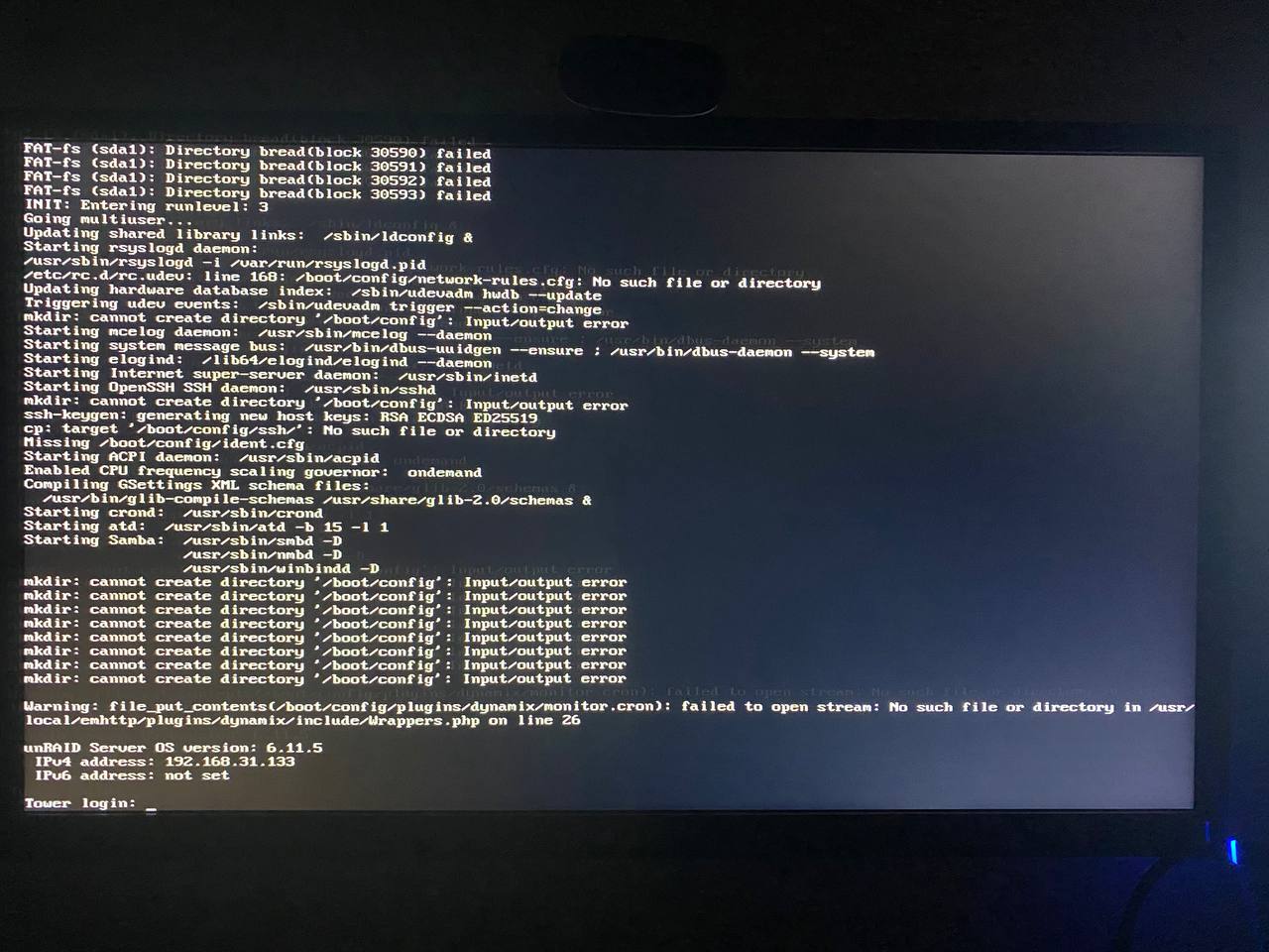

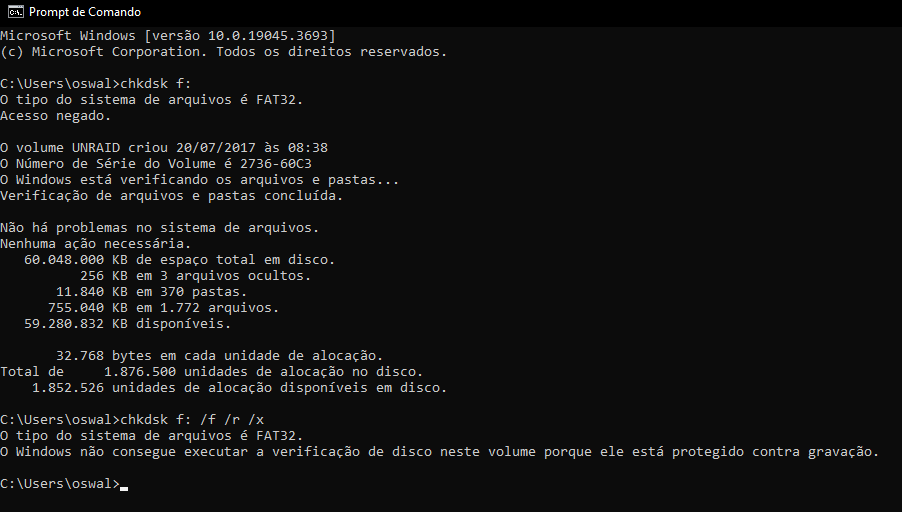

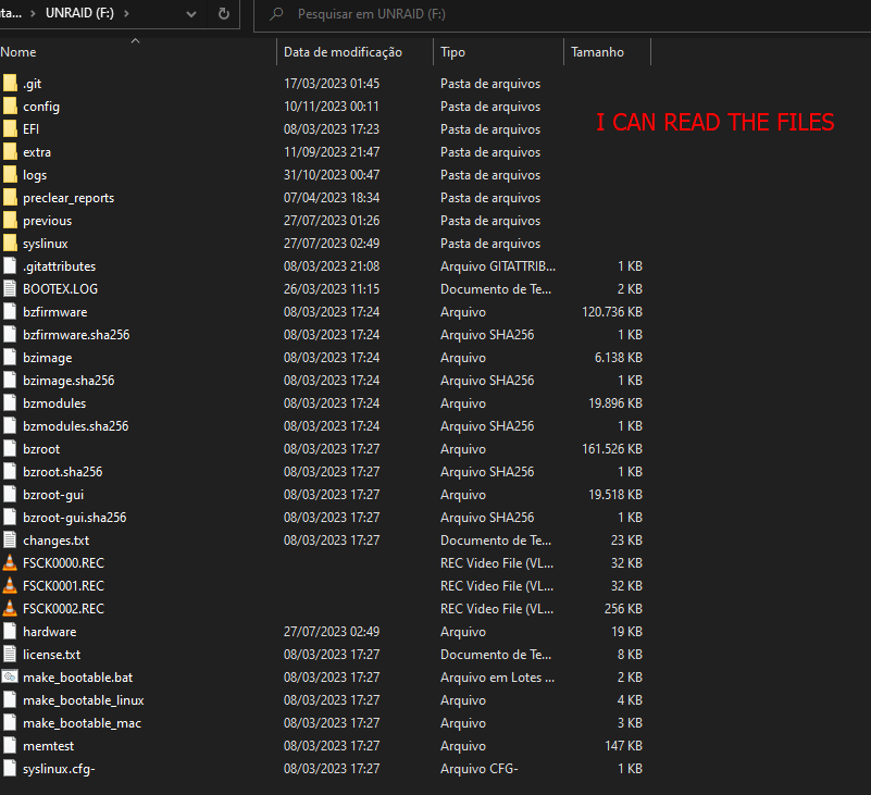

  3. Hello. I have been an Unraid user for approximately 1 year. I've never had more serious problems, however, today I had a terrible surprise. My server didn't modify configuration files on the frontend, so I decided to reboot and see if that fixed it. To my disappointment, unraid no longer booted. On the bare metal preview screen I identify that the flash drive is in read-only state and there is nothing I can do to correct it. I turned off Unraid and removed the UFB flash drive to try a disk check in Windows. Once again the USB is in full Read Only status. Fortunately (I believed) I had made a backup last week, so I tried to put it on another USB drive, as the original was unusable. I then used Unraid USB Creator to generate the flash drive with my backup. However, Unraid did not start! It reported errors again and gave me a login screen with the name "Tower" without the possibility of typing anything using the keyboard. I'm a little desperate. Could anyone help me get through this? I know that the data must be preserved, but my settings, Shares, Dockers, Virtual Machines... I don't know how to recover them.
