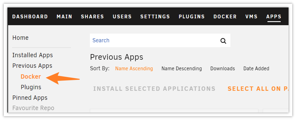

Assuming the appdata is intact the docker image can easily be recreated, for libvirt looks like you have a backup, see if that one has your VMs, if not you'll need to recreate them, but you can point to the existing vdisks.
well, how? recovery from Appdata backup?
also, is that possible to recovery docker without delete docker.img and reinstall?
i do really have too many dockers which need to be installed.
You can install previous docker from CA, just select and install.
