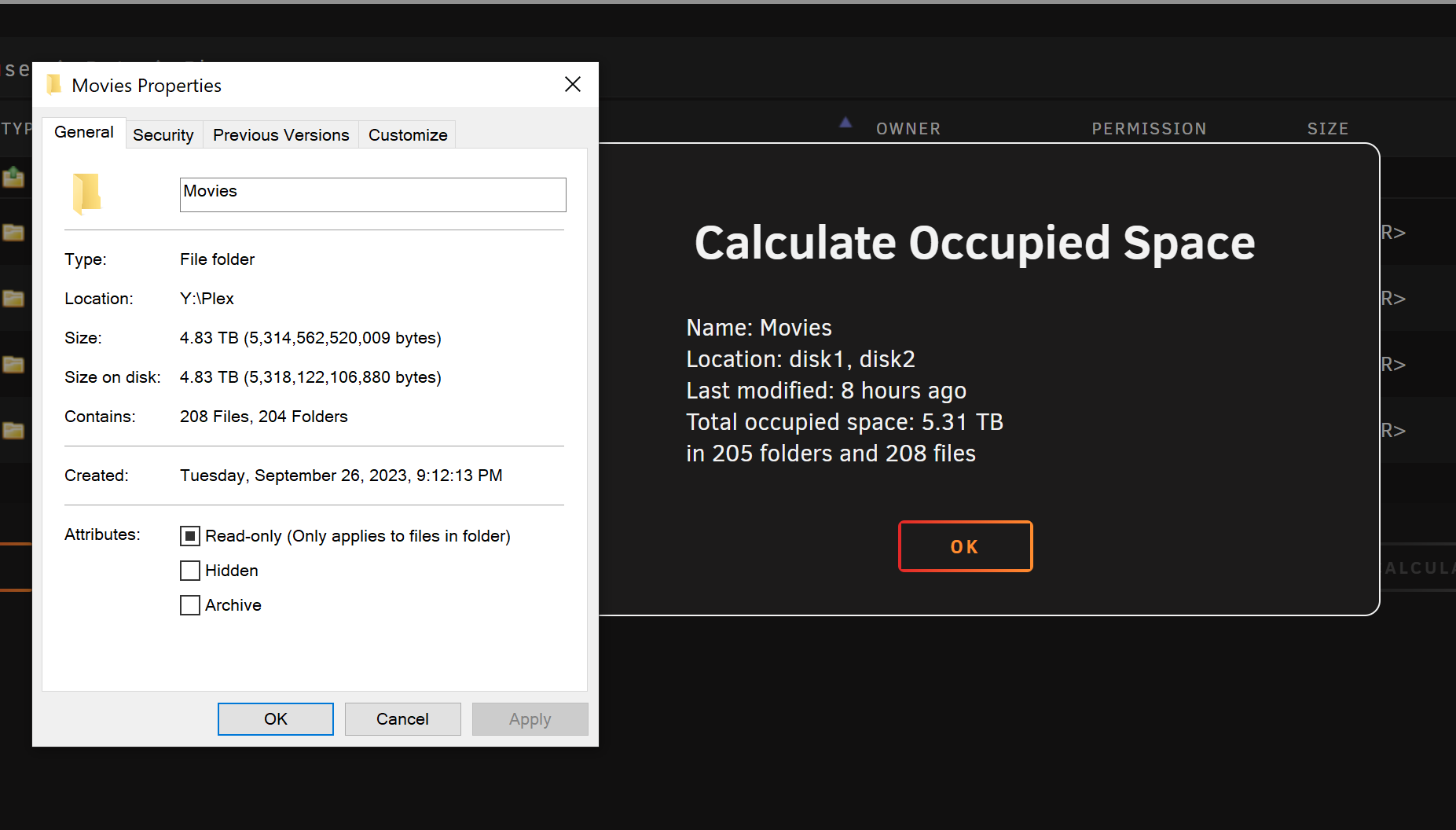

So another thing I have a question about. I setup my array with my 3 x 8tb drives 2 for data and one for parity. I also installed dynamix file manager. I mounted my usb drive that had my plex media files on it, and initialized a transfer. It started out at 125-200 MB/s and then slowed to 10-15 MB/s the next day. It is about 6 tb of data. So I stopped the transfer. Read something about removing the parity drive during the transfer so I did that. Started the transfer again. It was going much faster but then seemed to slow again.
The weird thing I noticed is when I was transferring with the partiy drive as part of the array but the parity check paused. The data was being put on both disk 1 and disk 2 fairly evenly. Since removing the partiy drive and starting the transfer again. It appears to be filling up one drive first and not distributing evenly. I also notice that it seems to be taking up more space on the Unraid array than the USB drive. I looked to see if there were duplicate files but I didn't see any. Not sure if there is an easy way to check for this?
Basically what is the best way I have to check the number of files and size of the plex folder on my USB drive and compare it to the number of files and size on the array?
It seems that the transfer has created duplicates of files but I can't find them?
If you're transferring to a user share don't see how there could be duplicates, but you can share it over SMB and then with Windows explorer right click on the folder(s) and click properties to show how many folders/files are inside.
I actually did that last night and did notice that the number of files and folders were the same but the size of a couple folders were larger on the Unraid array then they were on the external drive while others are the same size.
It looks like the size shows differently in windows explorer than it does when clicking calculate in unraid.
If I am seeing this correcty it looks like Unraid reports the claimed TB space of the drive not the "actual" like windows, becuse it says 5.31 TB on Unraid and I see that matches the amount of bytes in windows. But maybe I am wrong?
There are two possible things coming into play.   One is the difference between decimal GB and GiB (binary v Decimal), and the other is space occupied rather than size of the data in the files.
Yeah I figured that out as I was posting it. That would be why my drives show at 7.9TB of free space in Unraid but were showing as 7.1TB in windows. It is just something I have to get used to. Thanks for bearing with my learning and helping me out. New to Unraid, and linux in general.
