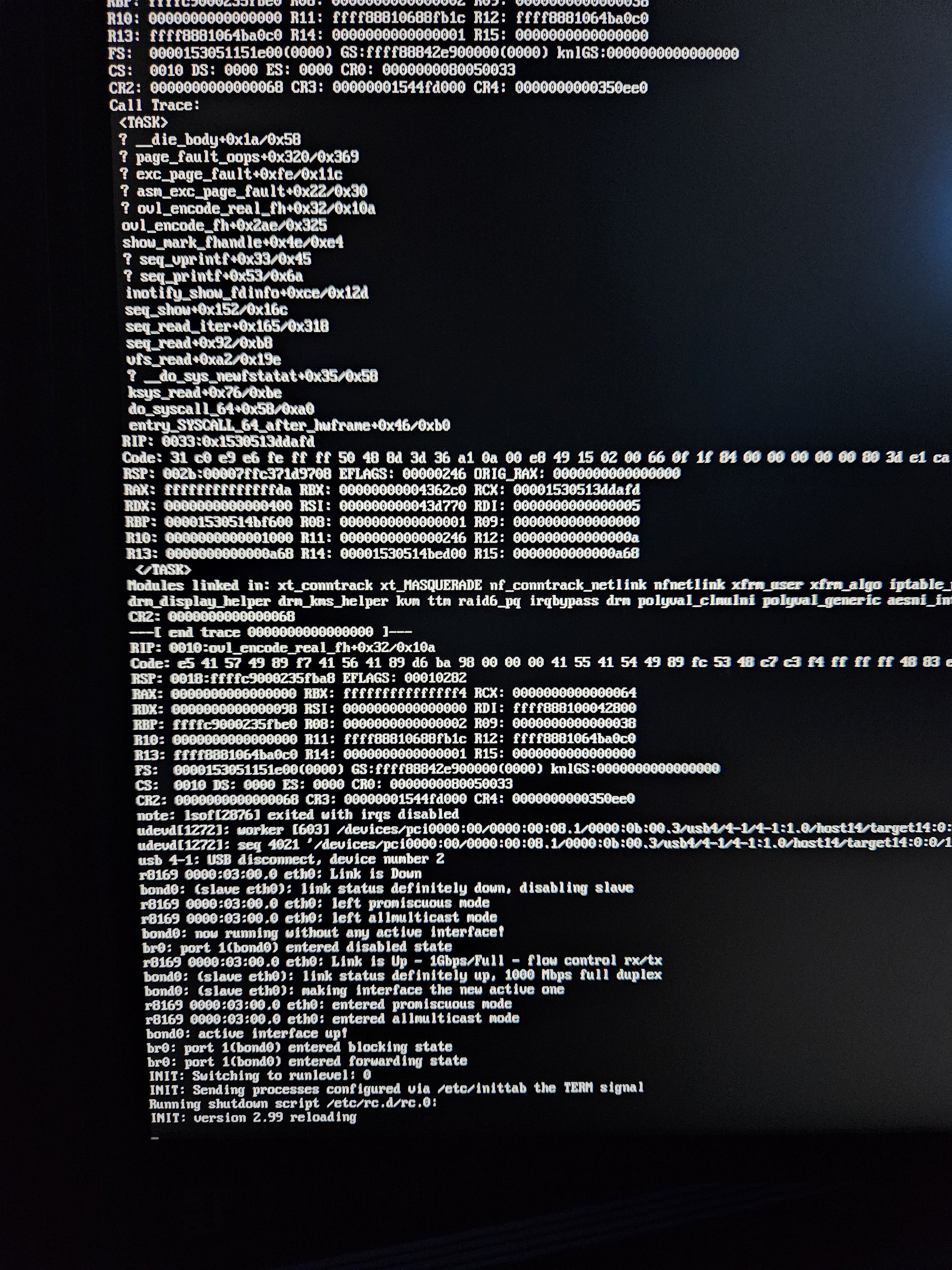

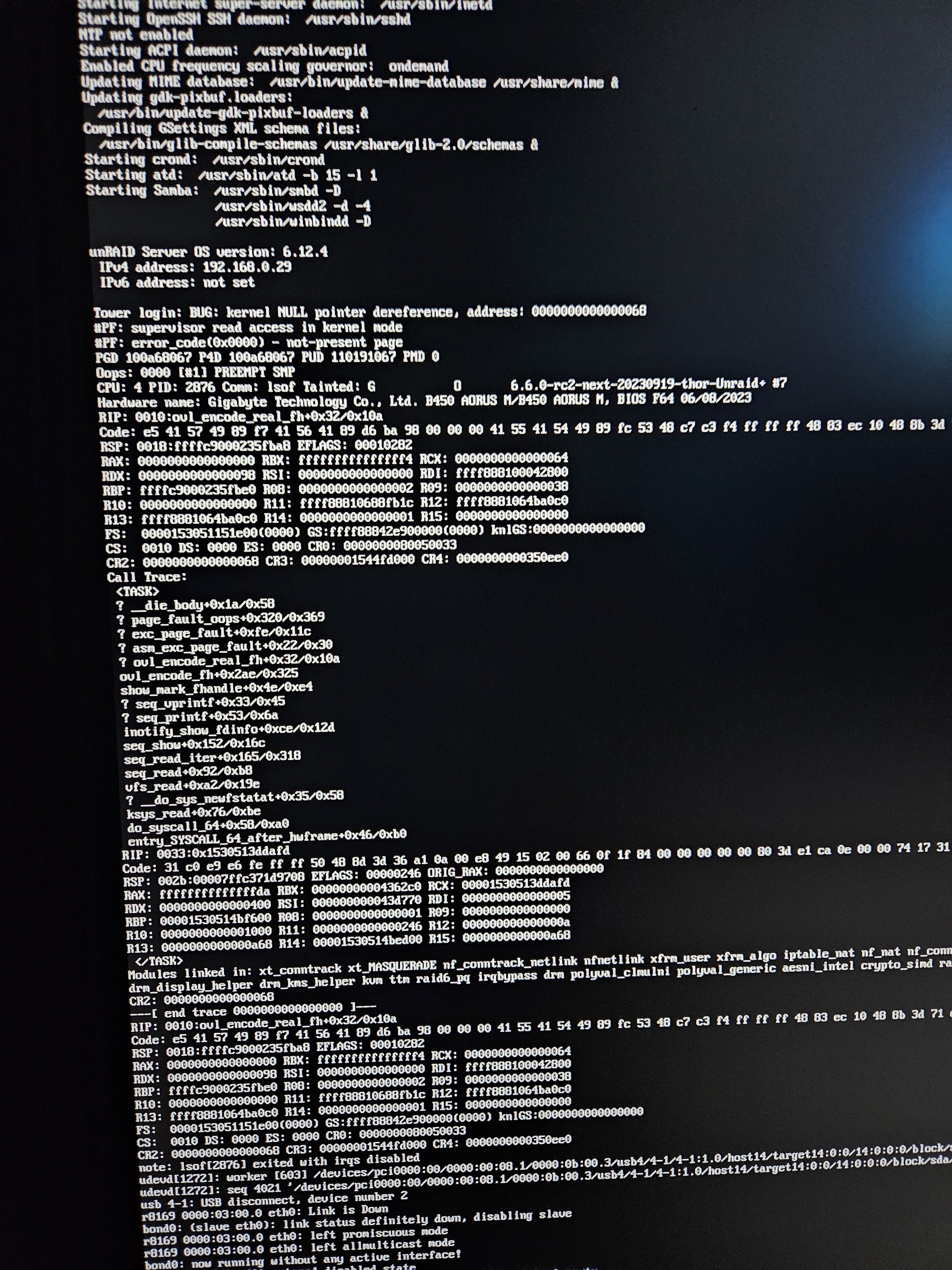

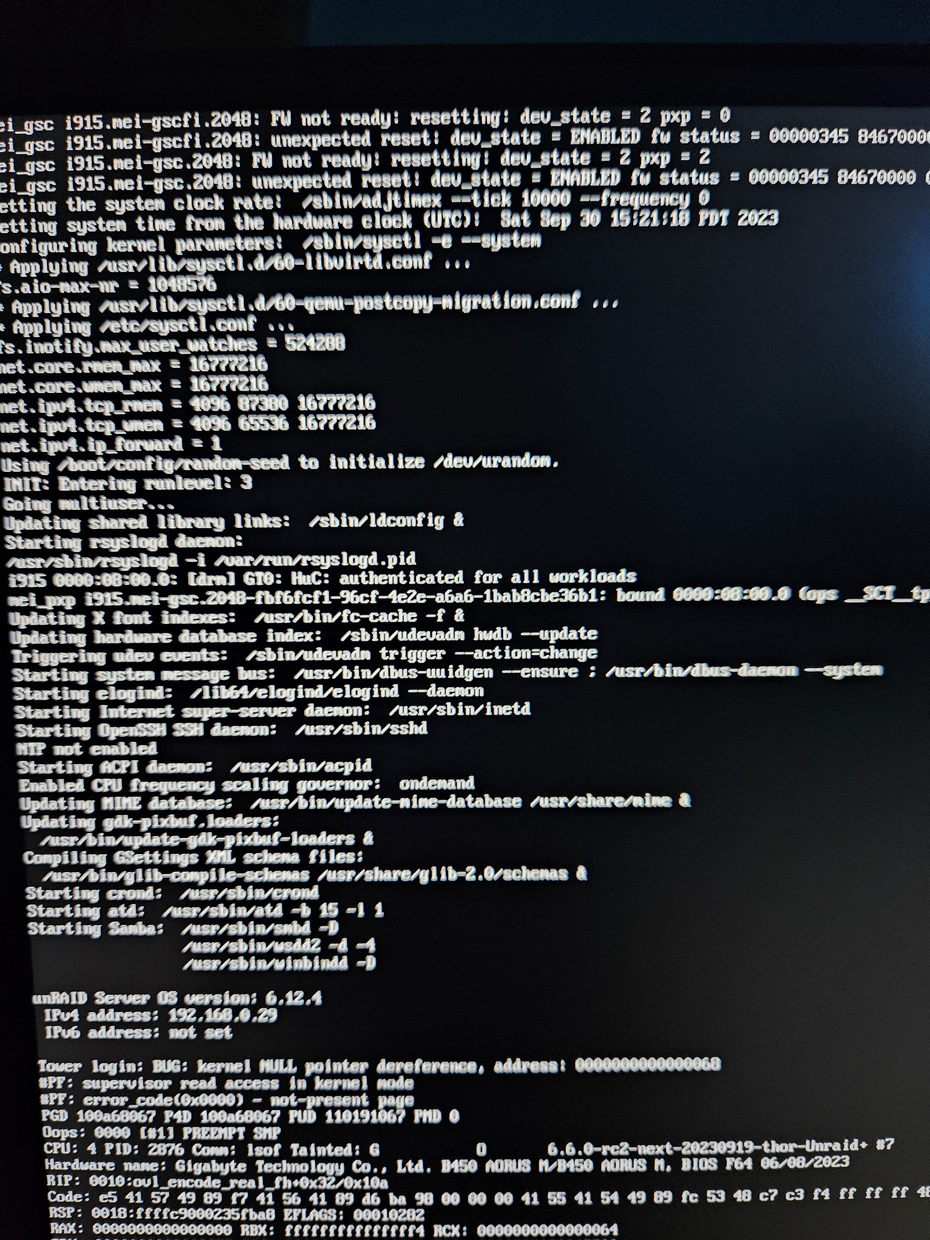

I plugged a monitor in and tapped the power button. This is what appeared. It was initially a black screen until I touched the power button.
The ip address has changed compared to what it was yesterday. It still doesn't respond to the hostname and that is shown as unreachable in a browser. Using the new ip from the pictures 192.168.0.29 gets a time out error.

I tapped the power button and those picture above show it started running the shutdown script however it's been 15 minutes now and nothing has happened. The shutdown delay is 7 minutes (420 seconds as mention in the OP). It should have shutdown by now.
I had to power it off by holding the power button because 25 minutes after tapping it, nothing was happening. Prior to that I tried plugging a keyboard. The screen updated to show it recognized a keyboard was plugged in but I wasn't able to type anything. Pressing keys didn't result in any letters appearing on the screen.

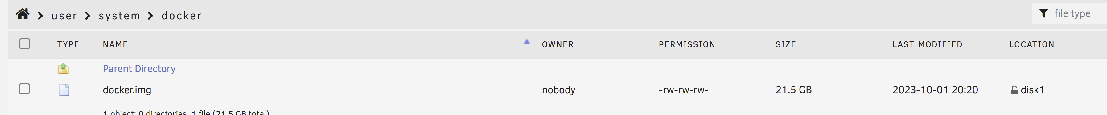

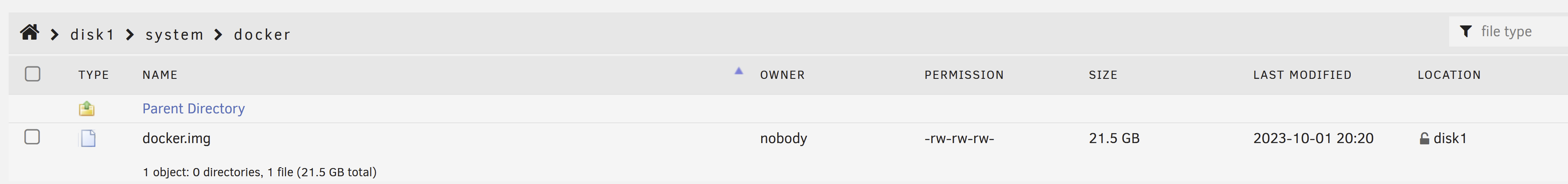

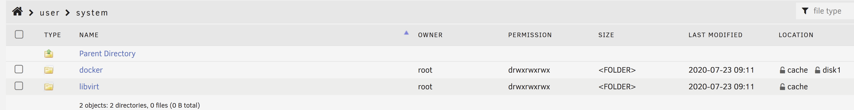

Would it be ok to delete the system folder from disk1? I have set the system folder to have the cache ssd as the primary storage. I disabled docker and vm manager then invoked mover. The system folder moved the cache. However I still see a system folder on disk 1 with a docker folder and image in it. The modified times are the same on both folders.  Disk1 is the disk that the diagnostics log reports never spins down because it's busy all the time. I'm wondering if this duplicated system folder is related to that issue.  Should I delete it off disk1 even though the date modified is the same as the cache drive system folder?
