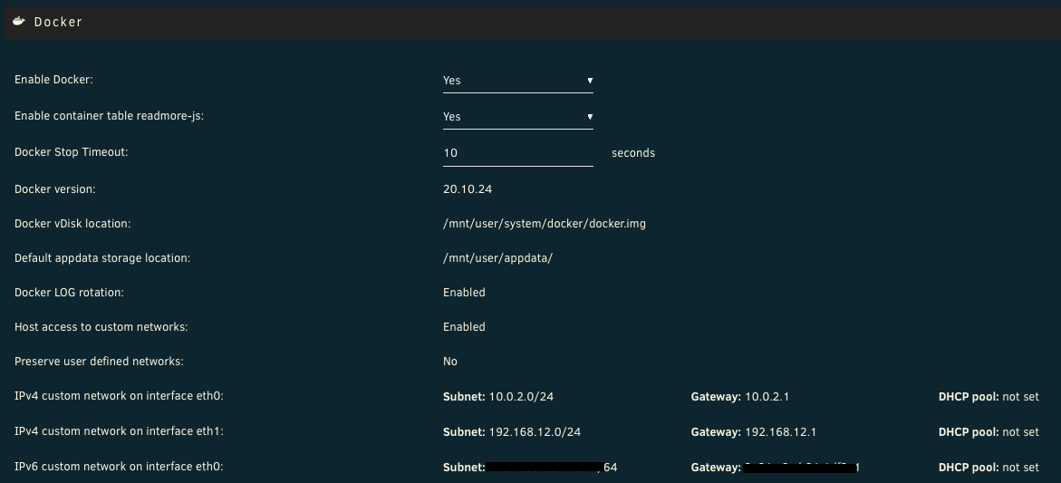

Second, the ipv6 is not available for docker containers. The ipv6 subnet doesn't appear in the EDIT view of the containers. So I had to remove it from each of them to be able to start them.
My docker network type is ipvlan.

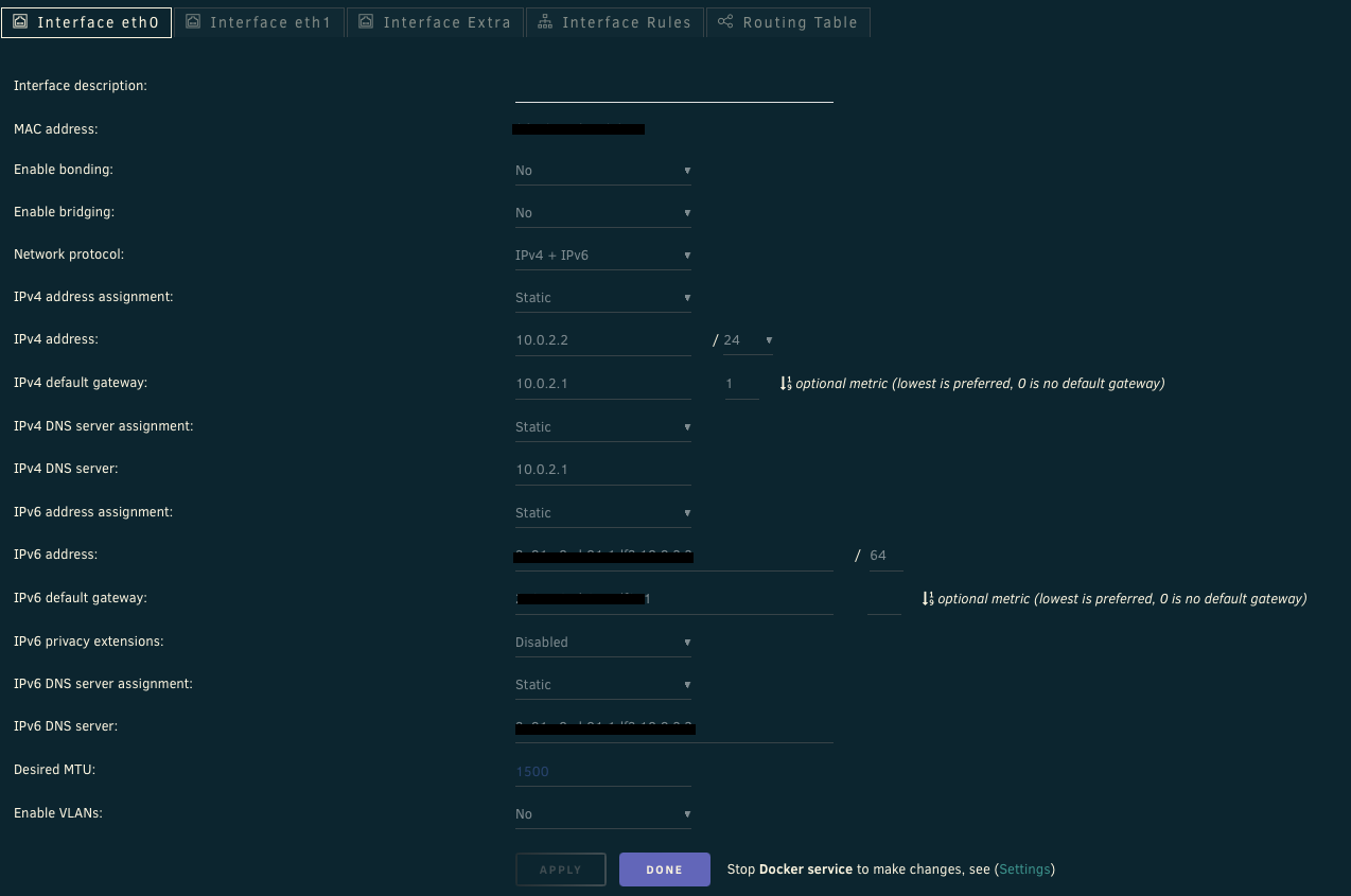

My config is the following:

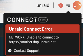

Also, I have a error message:
I believe it's not related to ipv6 but it also appeared with the last update.
